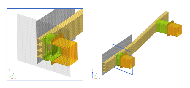

Figure 1. Full Model and Sub-Model

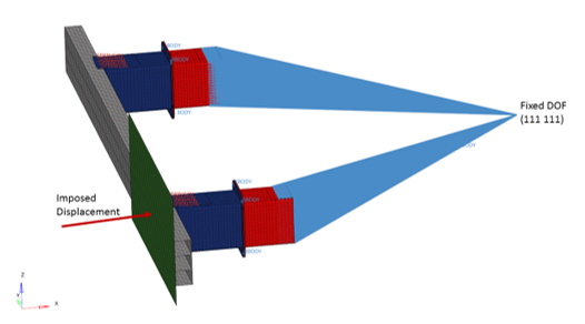

The full model contains a rigid plate with an imposed displacement that impacts the bumper. The crash box behind the bumper is fixed in all directions. Contact is defined between the parts using /INTER/TYPE7. Advanced mass scaling is used to reduce the solution time of the model.
Figure 2. Problem Description
Units: mm, ms, kg, N, GPa
The result of the full bumper model shows that most of the deformation is in the crash box area, which is just behind the rigid plate. The crash box on the other side shows very little deformation. The term sub-model refers to a smaller model that is created by cutting or trimming the full model. This is different than the //SUBMODEL model organization method that can be used in Radioss.

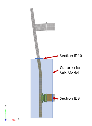

Figure 3. Full Model Results with Suggested Cut Location to Create the Sub-Model
In order to focus on the crash box area just behind rigid plate, the sub-model (blue highlighted area in Figure 3) is cut from the full model. To have the same behavior as the sub-model and the full model, the force and displacement on the boundary of the selected are needed. Using /SECT, it is possible to save and read section force or displacement.

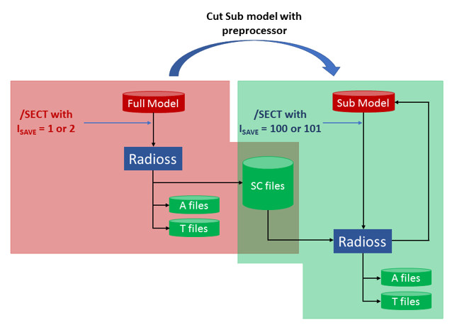

In this example, two sections (section ID 10 and ID 9) are defined in the full model. The HyperCrash, Process, Submodeling option was used to define the sections to the full model and create the sub-model. This process will create the /SECT in the full model with ISAVE=2 to save the section displacement or section force data during the computation with frequency Δt . The file name of section data (SC file) is defined in /SECT, flag_name. Next, use the SC files created from the full model as input to the smaller sub-model. Using the same /SECT definitions as the full model, change ISAVE=101 to read the section data from the SC file created from the full model.
Note: The /SECT, Δt input how often the section displacement and force results are written to the SC file. If Δt is too small, it can lead to very large SC output files. However, if Δt is too big, then the results may be wrong due to aliasing. A recommended value for Δt is 10 times the model timestep.
The node groups and element groups in the section should be the same in the full model and sub-model to ensure consistency between the forces. It is also possible to use HyperMesh to create the /SECT in the full model and create the sub-model by deleting elements from the full model.
Figure 4. Cut Methodology in Radioss

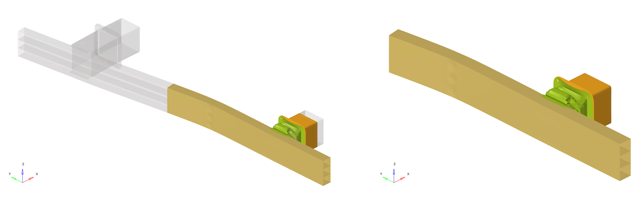

The correlation of deformation in the crash box in the full model and sub-model is good.
Figure 5. Deformation Overlay of the Full Model and Sub-Model

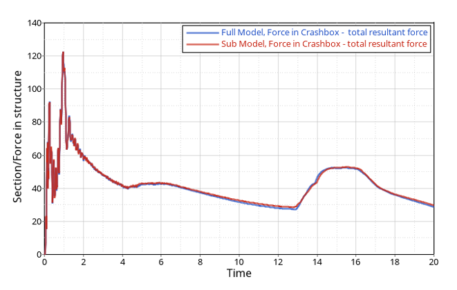

Figure 6. Section Force in Deformed Crash Box in Full Model and Sub-Model
The cross-section force in the crush box is very similar between the two simulations. If the sub-model results are very different than the full model, more section output results can be saved in the SC file by reducing the /SECT Δt . Alternatively, the location of the sections could be modified to include a larger area from the full model that influence the deformation of the sub-model.
