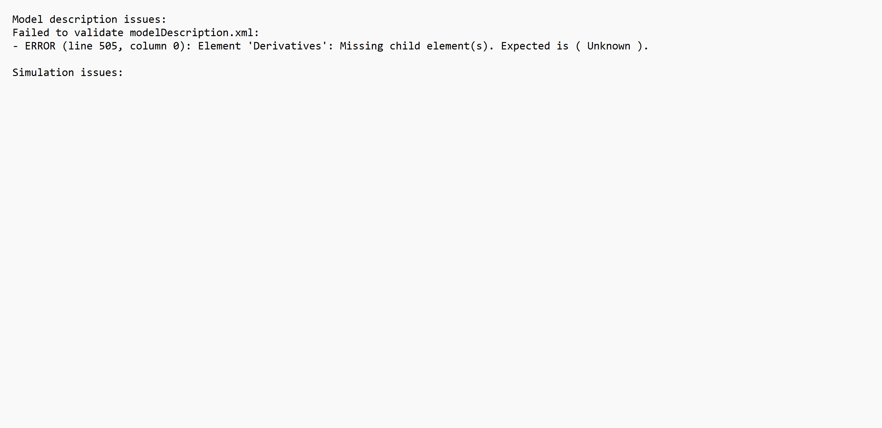

To run the FMU compliance checker to provide more information and verify the
validity of the FMU, click the Check FMU button, and then
click the Details button to open the log file.
Note: Check FMU will run the FMU through the FMU compliance checker as provided by the FMI standard. Along with the information about the contents of the FMU, the checker verifies the validity of the information and try to execute the FMU. Warnings or errors are posted in the resulting log file.
The application runs the Check FMU on the model containing an FMU during a Check Model|Export Solver Deck|Run simulation and may flag an error or warning.
FMU Compliance Check Log from Check FMU

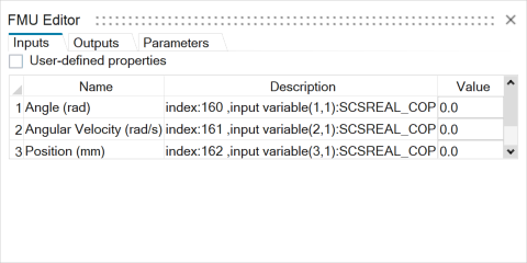

- In the Property Editor, select Edit to open the FMU Editor by.
- Open the FMU Editor by clicking on Edit... within the Property Editor
- Provide solver expressions for each of the channels under the Value column of the Input tab.

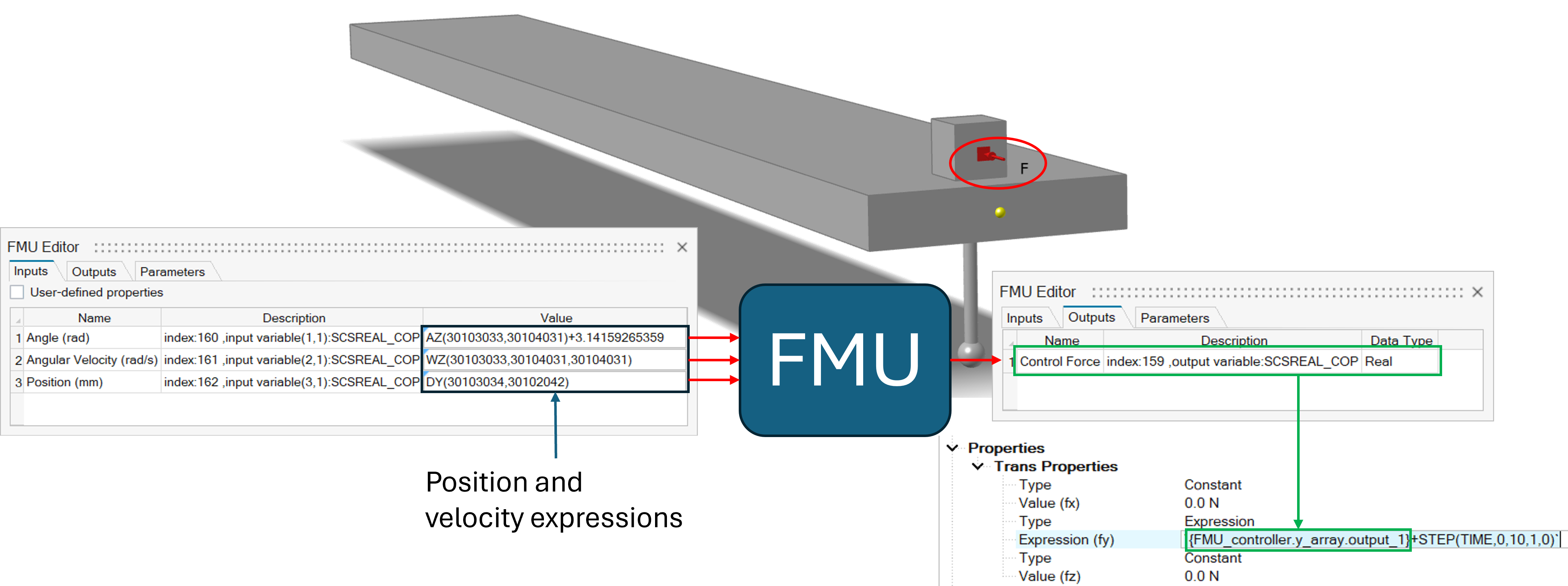

Define the FMU Outputs. These are referenced by Force or Motion entities in the
Model.
The expression for the Forces/Motions in the Model use the ARYVAL function to reference the FMU outputs. The FMU outputs are available as attributes to the
y_arraydata member of the FMU entity. For instance,{fmu_1.y_array.output_3}, will contain the third output of the FMU.Figure 1. Force expression referring to an output of an FMU
In the above model of a swing-up pendulum, the cart position and velocities captured by the solver expressions AZ(), WZ(), and DY() are provided as inputs to the FMU. The output from the FMU is tapped using the output attributes of the
y_arraydata member of the FMU that was resolved to the solver expression ARYVAL. In the demonstrated case, the force on the cart uses the first output. The expression{FMU_controller.y_array.output_1}returns the first output from the FMU’s (FMU_controller) output array (y_array).

appears. ![]() This dialog has the following tabs: Inputs The inputs tab lists all the input channels in the input array with their name and description. Provide a solver expression under the Value column to each of the channels as input to the FMU. The value of this solver expression is computed by MotionSolve during simulation and communicated to the FMU at every time-step of the simulation. To define how the input value is generated
during simulation using a custom expression or external
function, turn on User-defined
properties.
