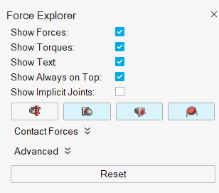

Review Motion Analysis Results Using the Force Explorer
Change the Time on the animation toolbar to
0.30 s by entering a value in the field or by
dragging the slider bar.
Click Run on the Motion ribbon, and then click
Force Explorer.
The Force Explorer appears. To undock the Force Explorer, click the title area and drag to the graphics area.
Press F to fit the model in the view.
Press the Play button on the animation toolbar. Notice
how the contact forces and torques in the motor and torsion spring develop as
the Geneva wheel is indexed around its axis.
- In the Force Explorer, toggle some of the checkboxes and entity buttons on/off, and experiment with some of the advanced options.
- In the Force Explorer, click the Reset button to revert to the default settings.
- Double-right-click in the modeling window to exit review mode, but notice that Force Explorer stays visible-which is what we want.
