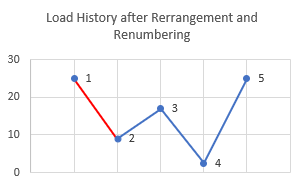

1, 2, 3, and 4 are the four peaks and valleys. Point 4 is the peak stress in the load history and moves to the front during rearrangement as shown in Figure 3. After rearrangement, the peaks and valleys are renumbered.
Figure 3.
Next, pick the first three stress values (1, 2, and 3) and determine if a cycle is present. If S i MathType@MTEF@5@5@+= feaahqart1ev3aqatCvAUfeBSjuyZL2yd9gzLbvyNv2CaerbuLwBLn hiov2DGi1BTfMBaeXatLxBI9gBaerbd9wDYLwzYbItLDharqqtubsr 4rNCHbGeaGqiVu0Je9sqqrpepC0xbbL8F4rqqrFfpeea0xe9Lq=Jc9 vqaqpepm0xbba9pwe9Q8fs0=yqaqpepae9pg0FirpepeKkFr0xfr=x fr=xb9adbaqaaeGaciGaaiaabeqaamaabaabaaGcbaGaam4uamaaBa aaleaacaWGPbaabeaaaaa@37E6@ represents the stress value, point I, then
Δ S 12 = S 1 − S 2 MathType@MTEF@5@5@+= feaahqart1ev3aaatCvAUfeBSjuyZL2yd9gzLbvyNv2CaerbuLwBLn hiov2DGi1BTfMBaeXatLxBI9gBaerbd9wDYLwzYbItLDharqqtubsr 4rNCHbGeaGqiVu0Je9sqqrpepC0xbbL8F4rqqrFfpeea0xe9Lq=Jc9 vqaqpepm0xbba9pwe9Q8fs0=yqaqpepae9pg0FirpepeKkFr0xfr=x fr=xb9adbaqaaeGaciGaaiaabeqaamaabaabaaGcbaGaeyiLdqKaam 4uamaaBaaaleaacaaIXaGaaGOmaaqabaGccqGH9aqpdaabdaqaaiaa dofadaWgaaWcbaGaaGymaaqabaGccqGHsislcaWGtbWaaSbaaSqaai aaikdaaeqaaaGccaGLhWUaayjcSdaaaa@4287@
Δ S 23 = S 2 − S 3 MathType@MTEF@5@5@+= feaahqart1ev3aqatCvAUfeBSjuyZL2yd9gzLbvyNv2CaerbuLwBLn hiov2DGi1BTfMBaeXatLxBI9gBaerbd9wDYLwzYbItLDharqqtubsr 4rNCHbGeaGqiVu0Je9sqqrpepC0xbbL8F4rqqrFfpeea0xe9Lq=Jc9 vqaqpepm0xbba9pwe9Q8fs0=yqaqpepae9pg0FirpepeKkFr0xfr=x fr=xb9adbaqaaeGaciGaaiaabeqaamaabaabaaGcbaGaeyiLdqKaam 4uamaaBaaaleaacaaIYaGaaG4maaqabaGccqGH9aqpdaabdaqaaiaa dofadaWgaaWcbaGaaGOmaaqabaGccqGHsislcaWGtbWaaSbaaSqaai aaiodaaeqaaaGccaGLhWUaayjcSdaaaa@428C@
Since Δ S 12 ≥ Δ S 23 MathType@MTEF@5@5@+= feaahqart1ev3aqatCvAUfeBSjuyZL2yd9gzLbvyNv2CaerbuLwBLn hiov2DGi1BTfMBaeXatLxBI9gBaerbd9wDYLwzYbItLDharqqtubsr 4rNCHbGeaGqiVu0Je9sqqrpepC0xbbL8F4rqqrFfpeea0xe9Lq=Jc9 vqaqpepm0xbba9pwe9Q8fs0=yqaqpepae9pg0FirpepeKkFr0xfr=x fr=xb9adbaqaaeGaciGaaiaabeqaamaabaabaaGcbaGaeyiLdqKaam 4uamaaBaaaleaacaaIXaGaaGOmaaqabaGccqGHLjYScqGHuoarcaWG tbWaaSbaaSqaaiaaikdacaaIZaaabeaaaaa@3F8A@ , no cycle is extracted from point 1 to 2. Now consider the next three points as follows:
Δ S 34 = S 3 − S 4 MathType@MTEF@5@5@+= feaahqart1ev3aqatCvAUfeBSjuyZL2yd9gzLbvyNv2CaerbuLwBLn hiov2DGi1BTfMBaeXatLxBI9gBaerbd9wDYLwzYbItLDharqqtubsr 4rNCHbGeaGqiVu0Je9sqqrpepC0xbbL8F4rqqrFfpeea0xe9Lq=Jc9 vqaqpepm0xbba9pwe9Q8fs0=yqaqpepae9pg0FirpepeKkFr0xfr=x fr=xb9adbaqaaeGaciGaaiaabeqaamaabaabaaGcbaGaeyiLdqKaam 4uamaaBaaaleaacaaIZaGaaGinaaqabaGccqGH9aqpdaabdaqaaiaa dofadaWgaaWcbaGaaG4maaqabaGccqGHsislcaWGtbWaaSbaaSqaai aaisdaaeqaaaGccaGLhWUaayjcSdaaaa@4290@
Δ S 23 ≤ Δ S 34 MathType@MTEF@5@5@+= feaahqart1ev3aqatCvAUfeBSjuyZL2yd9gzLbvyNv2CaerbuLwBLn hiov2DGi1BTfMBaeXatLxBI9gBaerbd9wDYLwzYbItLDharqqtubsr 4rNCHbGeaGqiVu0Je9sqqrpepC0xbbL8F4rqqrFfpeea0xe9Lq=Jc9 vqaqpepm0xbba9pwe9Q8fs0=yqaqpepae9pg0FirpepeKkFr0xfr=x fr=xb9adbaqaaeGaciGaaiaabeqaamaabaabaaGcbaGaeyiLdqKaam 4uamaaBaaaleaacaaIYaGaaG4maaqabaGccqGHKjYOcqGHuoarcaWG tbWaaSbaaSqaaiaaiodacaaI0aaabeaaaaa@3F7D@ , so a cycle is extracted from point 2 to 3. Since a cycle has been extracted, delete the two points from the graph.

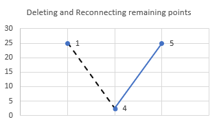

Figure 4.
Apply the same process to the remaining points:
Δ S 14 = S 1 − S 4 MathType@MTEF@5@5@+= feaahqart1ev3aqatCvAUfeBSjuyZL2yd9gzLbvyNv2CaerbuLwBLn hiov2DGi1BTfMBaeXatLxBI9gBaerbd9wDYLwzYbItLDharqqtubsr 4rNCHbGeaGqiVu0Je9sqqrpepC0xbbL8F4rqqrFfpeea0xe9Lq=Jc9 vqaqpepm0xbba9pwe9Q8fs0=yqaqpepae9pg0FirpepeKkFr0xfr=x fr=xb9adbaqaaeGaciGaaiaabeqaamaabaabaaGcbaGaeyiLdqKaam 4uamaaBaaaleaacaaIXaGaaGinaaqabaGccqGH9aqpdaabdaqaaiaa dofadaWgaaWcbaGaaGymaaqabaGccqGHsislcaWGtbWaaSbaaSqaai aaisdaaeqaaaGccaGLhWUaayjcSdaaaa@428C@
Δ S 45 = S 4 − S 5 MathType@MTEF@5@5@+= feaahqart1ev3aqatCvAUfeBSjuyZL2yd9gzLbvyNv2CaerbuLwBLn hiov2DGi1BTfMBaeXatLxBI9gBaerbd9wDYLwzYbItLDharqqtubsr 4rNCHbGeaGqiVu0Je9sqqrpepC0xbbL8F4rqqrFfpeea0xe9Lq=Jc9 vqaqpepm0xbba9pwe9Q8fs0=yqaqpepae9pg0FirpepeKkFr0xfr=x fr=xb9adbaqaaeGaciGaaiaabeqaamaabaabaaGcbaGaeyiLdqKaam 4uamaaBaaaleaacaaI0aGaaGynaaqabaGccqGH9aqpdaabdaqaaiaa dofadaWgaaWcbaGaaGinaaqabaGccqGHsislcaWGtbWaaSbaaSqaai aaiwdaaeqaaaGccaGLhWUaayjcSdaaaa@4294@
In this case, Δ S 14 = Δ S 45 MathType@MTEF@5@5@+= feaahqart1ev3aqatCvAUfeBSjuyZL2yd9gzLbvyNv2CaerbuLwBLn hiov2DGi1BTfMBaeXatLxBI9gBaerbd9wDYLwzYbItLDharqqtubsr 4rNCHbGeaGqiVu0Je9sqqrpepC0xbbL8F4rqqrFfpeea0xe9Lq=Jc9 vqaqpepm0xbba9pwe9Q8fs0=yqaqpepae9pg0FirpepeKkFr0xfr=x fr=xb9adbaqaaeGaciGaaiaabeqaamaabaabaaGcbaGaeyiLdqKaam 4uamaaBaaaleaacaaIXaGaaGinaaqabaGccqGH9aqpcqGHuoarcaWG tbWaaSbaaSqaaiaaisdacaaI1aaabeaaaaa@3ED0@ so another cycle is extracted from point 1 to 4. These two points are discarded. There are five points remaining, therefore the rainflow counting process is complete.
Two cycles (2 → 3 and 1 → 4) have been extracted from this load history. One of the main reasons for choosing the highest peak/valley and rearranging the load history is to guarantee that the largest cycle is always extracted (in this case, it is 1 → 4). If you observe the load history prior to rearrangement, and conduct the same rainflow counting process on it, the 1 → 4 cycle is not extracted.

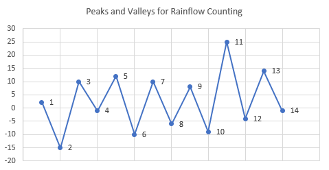

Since this load history is continuous, it is converted into a load history consisting of peaks and valleys only, as follows:
Figure 6.

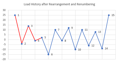

Load point 11 is the highest valued load, so the load history is now rearranged and renumbered as follows:
Figure 7.
The load history is rearranged so all points including and after the highest load are moved to the beginning of the load history and are removed from the end of the load history.
