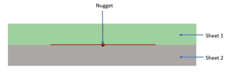

Currently, only stress-life (SN) based spot weld fatigue analysis is supported. The spot weld location is defined by three attributes, sheet 1, sheet 2, and the nugget.
Figure 1. Spot Weld Fatigue

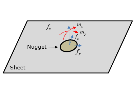

Figure 2. Forces and Moments of Interest at Sheet Locations
Radial stresses are calculated at the sheet by considering forces and moments at the nugget. The radial stresses σ ( θ ) are calculated as a function of θ for each point in the load-time history as:
σ(θ)=− σ max ( f y )cosθ− σ max ( f z )sinθ+σ( f x )+ σ max ( m y )sinθ− σ max ( m z )cosθ MathType@MTEF@5@5@+= feaahqart1ev3aqatCvAUfeBSjuyZL2yd9gzLbvyNv2CaerbuLwBLn hiov2DGi1BTfMBaeXatLxBI9gBaerbd9wDYLwzYbItLDharqqtubsr 4rNCHbGeaGqiVu0Je9sqqrpepC0xbbL8F4rqqrFfpeea0xe9Lq=Jc9 vqaqpepm0xbba9pwe9Q8fs0=yqaqpepae9pg0FirpepeKkFr0xfr=x fr=xb9adbaqaaeGaciGaaiaabeqaamaabaabaaGcbaGaeq4WdmNaai ikaiabeI7aXjaacMcacqGH9aqpcqGHsislcqaHdpWCdaWgaaWcbaGa ciyBaiaacggacaGG4baabeaakiaacIcacaWGMbWaaSbaaSqaaiaadM haaeqaaOGaaiykaiGacogacaGGVbGaai4CaiabeI7aXjabgkHiTiab eo8aZnaaBaaaleaaciGGTbGaaiyyaiaacIhaaeqaaOGaaiikaiaadA gadaWgaaWcbaGaamOEaaqabaGccaGGPaGaci4CaiaacMgacaGGUbGa eqiUdeNaey4kaSIaeq4WdmNaaiikaiaadAgadaWgaaWcbaGaamiEaa qabaGccaGGPaGaey4kaSIaeq4Wdm3aaSbaaSqaaiGac2gacaGGHbGa aiiEaaqabaGccaGGOaGaamyBamaaBaaaleaacaWG5baabeaakiaacM caciGGZbGaaiyAaiaac6gacqaH4oqCcqGHsislcqaHdpWCdaWgaaWc baGaciyBaiaacggacaGG4baabeaakiaacIcacaWGTbWaaSbaaSqaai aadQhaaeqaaOGaaiykaiGacogacaGGVbGaai4CaiabeI7aXbaa@78E3@
