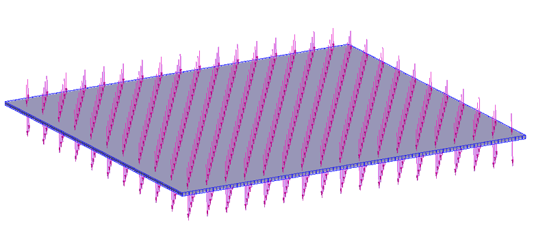

The plate is simulated as a 3D solid body. Spot-lines were created at the mid-plane of the plate in order to apply hinge supports (Figure 1). In order to simulate periodic load changing according to the formula above, two pressure loads were applied to the plate:
  • P = 100 ∗ sin ( ω ∗ t ) MathType@MTEF@5@5@+= feaagKart1ev2aaatCvAUfeBSjuyZL2yd9gzLbvyNv2CaerbwvMCKf MBHbqefqvATv2CG4uz3bIuV1wyUbqedmvETj2BSbqefm0B1jxALjhi ov2DaebbnrfifHhDYfgasaacH8qrps0lbbf9q8WrFfeuY=Hhbbf9v8 qqaqFr0xc9pk0xbba9q8WqFfea0=yr0RYxir=Jbba9q8aq0=yq=He9 q8qqQ8frFve9Fve9Ff0dmeaacaGacmGadaWaaiqacaabaiaafaaake aacaWGqbGaeyypa0JaaGymaiaaicdacaaIWaGaey4fIOIaci4Caiaa cMgacaGGUbWaaeWaaeaacqaHjpWDcqGHxiIkcaWG0baacaGLOaGaay zkaaaaaa@45C6@ to the top surface of the plate, and
  • P = − 100 ∗ sin ( 3 ω ∗ t ) MathType@MTEF@5@5@+= feaagKart1ev2aaatCvAUfeBSjuyZL2yd9gzLbvyNv2CaerbwvMCKf MBHbqefqvATv2CG4uz3bIuV1wyUbqedmvETj2BSbqefm0B1jxALjhi ov2DaebbnrfifHhDYfgasaacH8qrps0lbbf9q8WrFfeuY=Hhbbf9v8 qqaqFr0xc9pk0xbba9q8WqFfea0=yr0RYxir=Jbba9q8aq0=yq=He9 q8qqQ8frFve9Fve9Ff0dmeaacaGacmGadaWaaiqacaabaiaafaaake aacaWGqbGaeyypa0JaeyOeI0IaaGymaiaaicdacaaIWaGaey4fIOIa ci4CaiaacMgacaGGUbWaaeWaaeaacaaIZaGaeqyYdCNaey4fIOIaam iDaaGaayjkaiaawMcaaaaa@4770@ to the bottom surface of the plate
