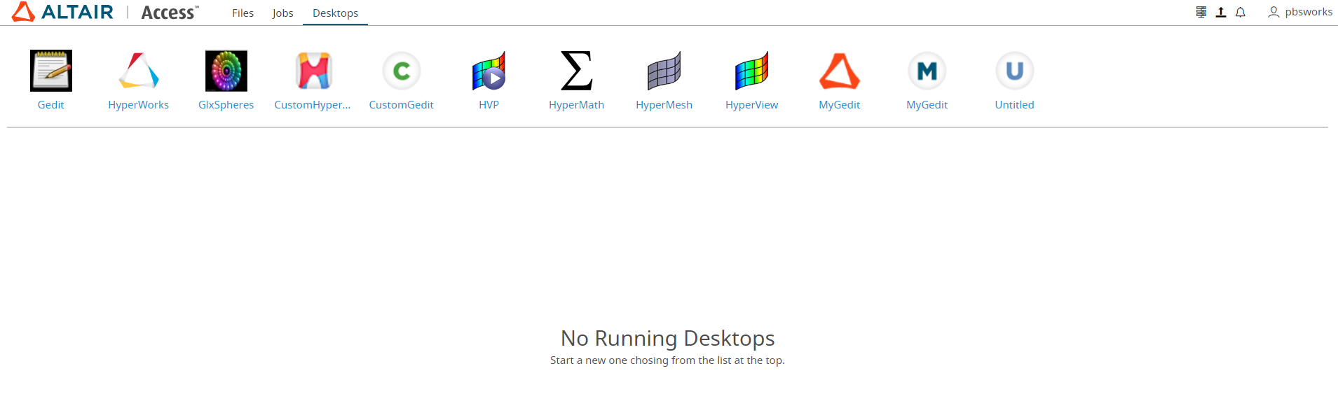

  1. Click the Desktops tab located in the upper left-hand of the page.
    A list of applications are displayed at the top of the Desktops page.
    Figure 1. Remote Desktops Applications/Solvers List
    Tip: Click to view the other applications/solvers.
    By default, the remote desktops list is displayed in the Tile view. Click to change the view to List view.

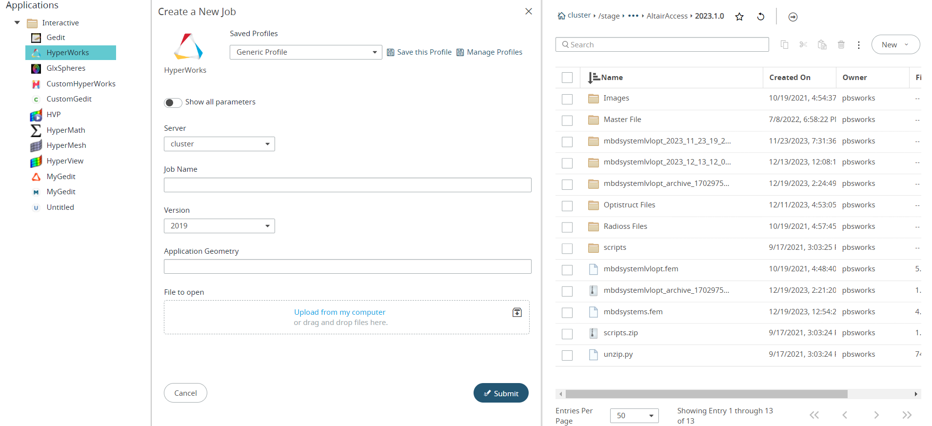

    A job submission form is displayed.
    Figure 2. Job Submission Form
    Job Submission Form
    The following panes are displayed in the Job Submission Form:
    • Left pane - Displays the list of Solvers based on the category.
    • Center pane - Displays the Job Submission Form. First time when you select an Application, Generic Profile is selected and subsequent time Last Submitted profile is selected. Profiles are displayed in a drop-down list next to the application.
    • Right pane - Displays the File Management section. You can perform all the file related activities in this section. For example, selecting a file as an input file or include files, selecting a directory as an output directory, editing a file, uploading a files, searching a file from the list.
    By default, only the required parameters are displayed. Move the toggle switch to the right to display all available application parameters.
  3. Fill in any required solver parameters.
    Application parameters are based on the application selected.
    Tooltip displays the description of the application parameters when you mouseover the parameters field.
    Note: The Server field will be displayed only if more than one Server Cluster is registered.
    Tip: Click Save this Profile to create a customized profile with the pre-populated parameters.
