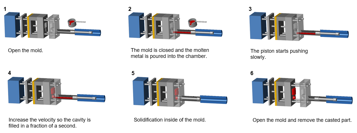

High pressure die casting uses a machine to inject molten metal into permanent metal dies under high pressure. It is a good technique for manufacturing complex parts with a high degree of accuracy, particularly lightweight parts with thin walls that require consistent dimensions. The high pressure is needed to fill the mold completely and avoid solidification during the casting process.
High pressure die casting uses two distinct velocities. The molten metal is first pushed at a low velocity (initial velocity) in order to avoid turbulence and the formation of bubbles. Just before the material enters the mold, the velocity increases (second phase velocity), and the molten metal is injected very quickly into the die assembly to fill it completely.

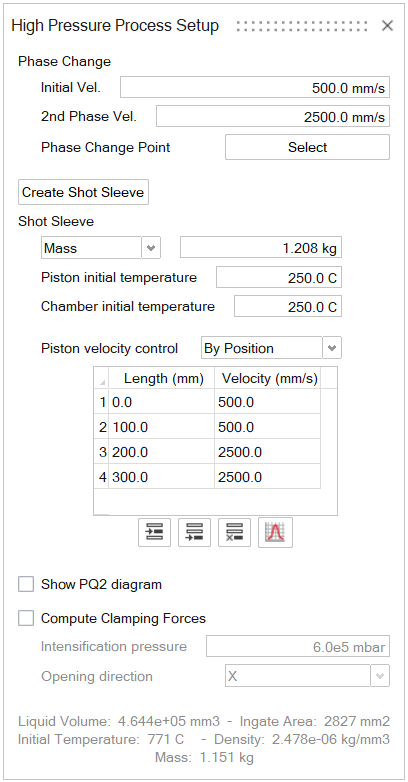

The High Pressure Process Setup window opens. -
Define the high pressure process parameters.
If no shot sleeve is present in the model, the High Pressure Process Setup window will appear as shown below.
If a shot sleeve is present in the model, the High Pressure Process Setup window will appear as shown below.
High Pressure Options
- Without Shot Sleeve
- When no shot sleeve is included in the model, the High
Pressure Process Setup window includes these controls:
- Initial Velocity (m/s)
- Typical values for Initial Velocity are 0.2–0.5 m/s.
- Second Phase Velocity (m/s)
- Typical values for Second Phase Velocity are 2.0–5.0 m/s.

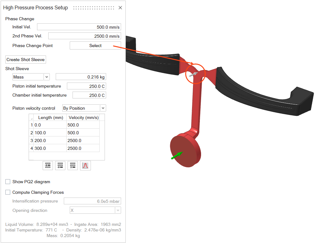

- Phase Change Point
- To specify where the initial velocity changes to the second
phase velocity, click Select, and
then click a point on the runner.Tip: The phase change point needs to be on the runner, before the material enters the mold.
- Create Shot Sleeve
- Click this button to open the Add/Edit Shot Sleeve tool and create a shot sleeve. When you exit the tool, the High Pressure Process Setup window will appear as described below.
- Shot Sleeve controls
- Mass/Sleeve Filled % menu
- Choose between mass or volume to define the amount of material in the shot sleeve. Mass is defined in standard units. Volume is expressed as a percentage of the shot sleeve's volume.
- Piston initial temperature
- This is the initial temperature of the piston before the material is added to the shot sleeve.
- Chamber initial temperature
- This is the temperature of the shot sleeve chamber before the material is added.
- Piston Velocity Control
- Select By position or
By time, and define the
piston velocity profile.
By position allows you to select the first and second velocity when the liquid reaches a selected position on the shot sleeve. The final position will be automatically edited depending on the designed shot sleeve length.
By time allows you to select the first and second piston velocity with respect to the filling time.
You can enter values in the table or edit the points on the graph. Click
to add a new row after a
selected data point, add a new row after the last
data point, or delete a selected row.
Click
icon to open the velocity
plot. You can drag the points on the plot to edit
them.

- Choose to change the piston's velocity based on the piston's position in the shot sleeve or based on elapsed time. Use the table to define the piston's velocity at different times or positions.
to
add a new row after a selected data point, add a
new row after the last data point, or delete a
selected row.
Click
them.

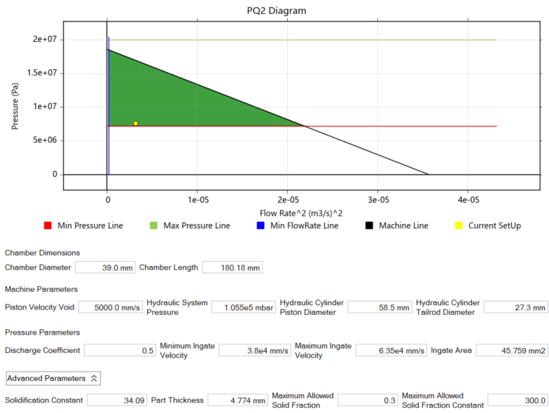

- PQ2 Diagram
- Enable the Show PQ2 diagram option to
reveal this tool. It can help you improve the machine setup
in the high-pressure die casting process. The diagram shows
a green safety region on a pressure vs flow rate graph. The
safety area is defined by the minimum and maximum pressure
and minimum and maximum flow rate during the casting
process.
The yellow Current Setup point in the diagram shows the current machine setup based on the settings in the Piston Velocity and Ingate Area fields.
