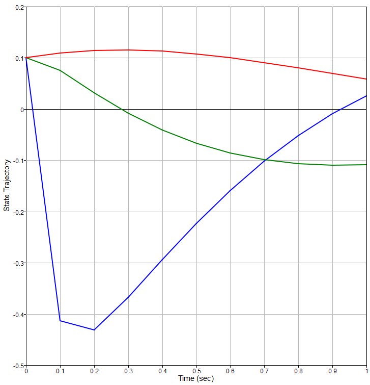

Example
Plot state trajectories: Figure 1.
A = [-20 -40 -60;1 0 0; 0 1 0];
B = [1; 0; 0];
C = [0 0 1];
D = 0;
T = [0:0.1:1]; % Time vector
U = zeros(size(T,1), size(T,2));
X0 = [0.1 0.1 0.1]; % Initial Condition
sys = ss(A, B, C, D);
[y, t, x] = lsim(sys, U, T, X0);
plot(t,x);
xlabel('Time (sec)');
ylabel('State Trajectory');
grid;
