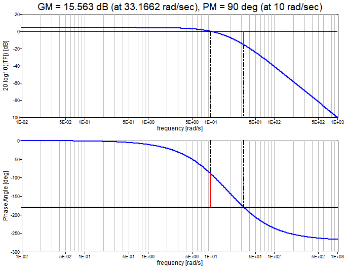

Example
Create the bode plot with the margin information for the system
below.Figure 1. margin Example
s = tf('s');
GH = 10000 / ((s+10)*(s+20)*(s+30));
margin(GH);
Comments
If the output arguments are omitted, the bode plot is displayed with the margin information.
