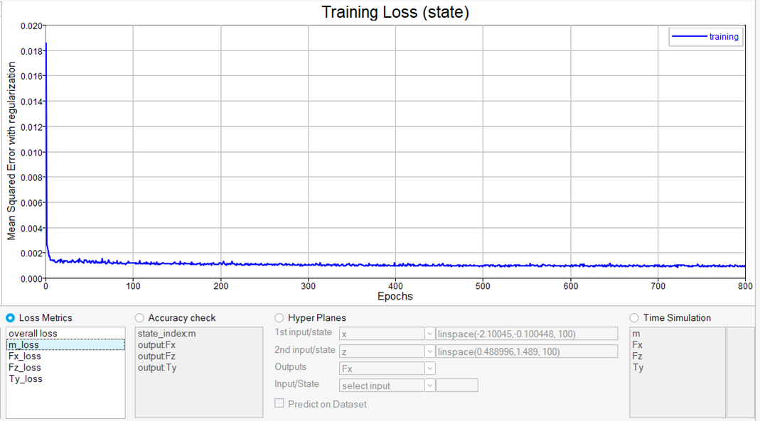

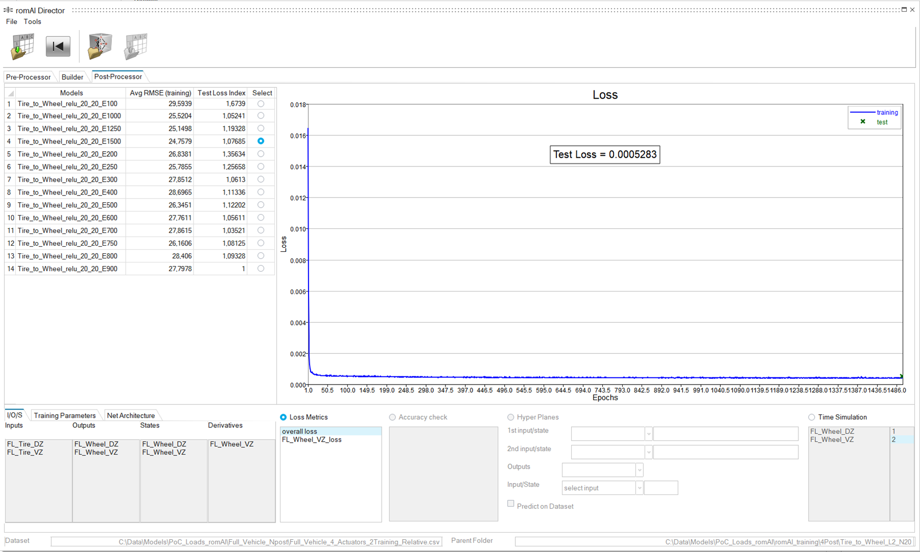

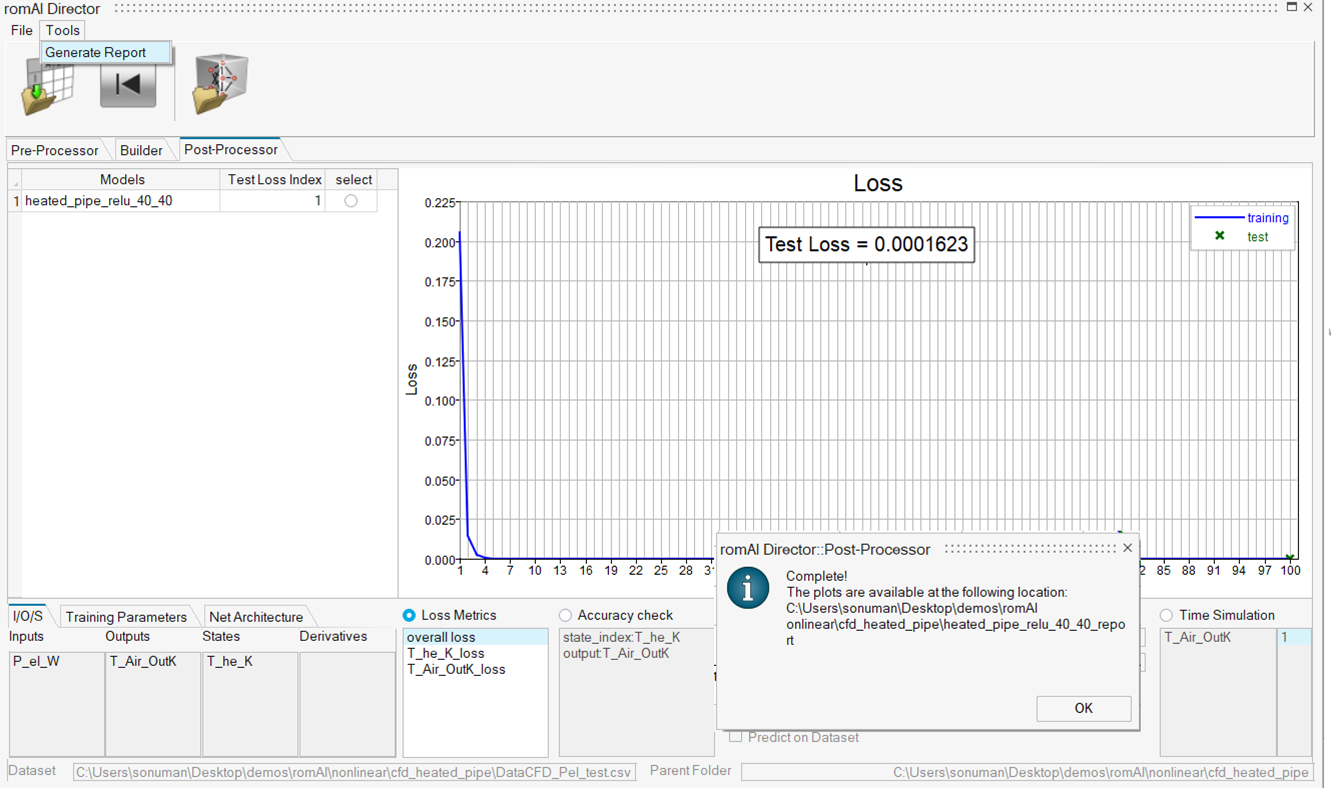

Check Loss

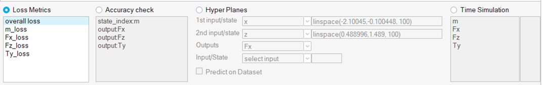

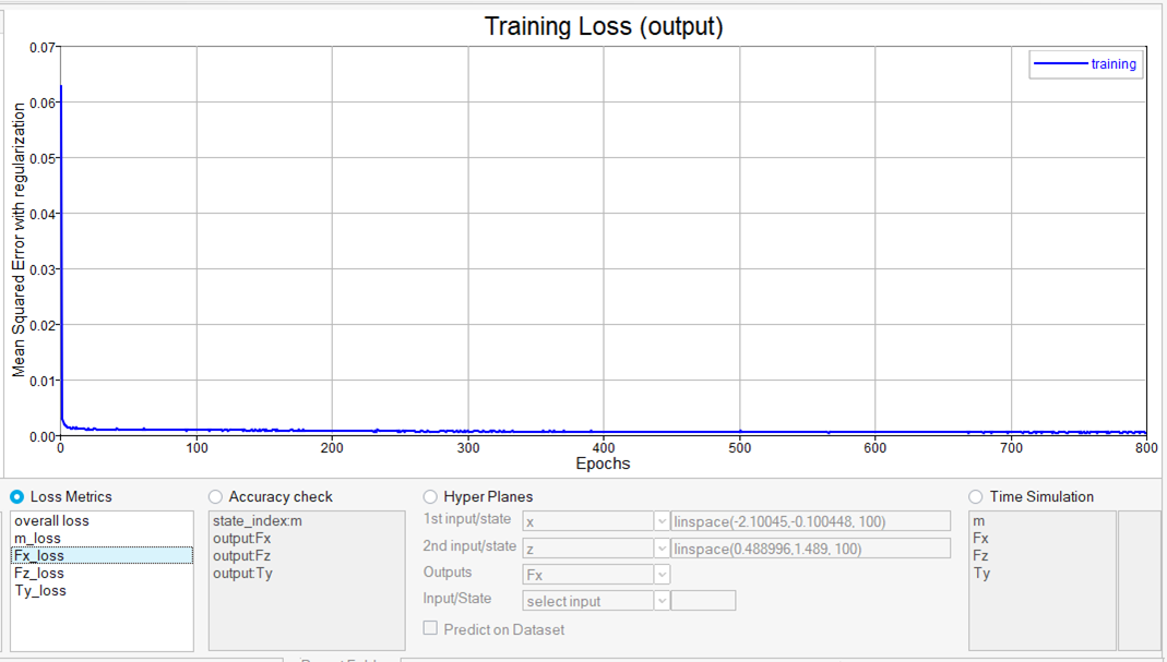

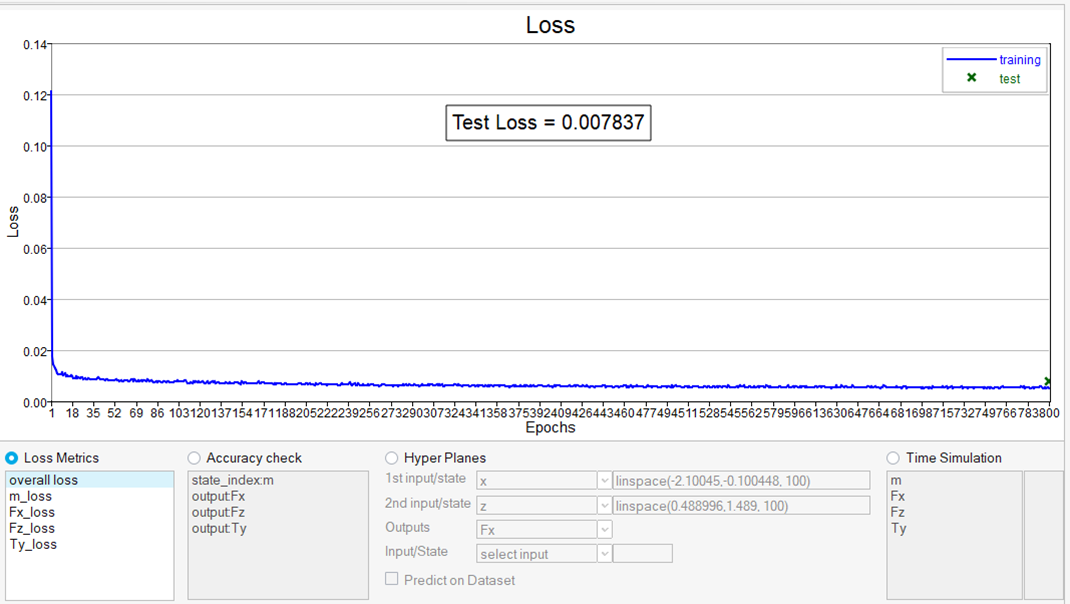

View the overall training, validation, and test loss.
Select the Loss Metrics radio button.
The data also shows the training/validation loss of each single output or higher-order state variable, such as velocity in this case.
- The lower the training error, the more accurate the ROM.
- If the training and test loss is close to each other, then the training has converged.

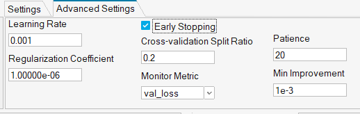

- If the training and test losses diverge, then the ROM might be affected by overfitting. In this case, you may want to consider increasing the regularization term.
- The cross-validation ratio is used to monitor the Early Stop criteria. To change the cross-validation ratio, select the Early Stopping check box as shown below.

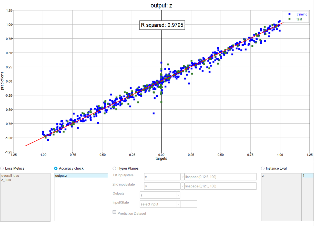

Check Accuracy
The R2 Accuracy check is applicable only for static models.
In the case of dynamic models to evaluate its prediction accuracy you may use the RMSE metric available in the Time Simulation tab.
Select the Accuracy check radio button.
Accuracy check requires a test dataset for prediction. If the test dataset is not provided or if it incompatible with the model feature names, then an error dialog box is shown.
The test dataset name is populated in the file name info entries on the bottom of the panel.
The training dataset is automatically loaded as test dataset in the post-processor just after the training. In this case, the training data points are shown with blue color and test data points are shown with green color.
The y-axis shows the predictions of the selected output produced by the romAI model, given the inputs defined in the dataset file.
The x-axis shows the targets for the same selected output contained in the same dataset file.
The closer that the predictions are to the targets, accordingly, more blue points will be aligned to the y = x curve, drawn in red.
The R2 coefficient gets computed automatically.

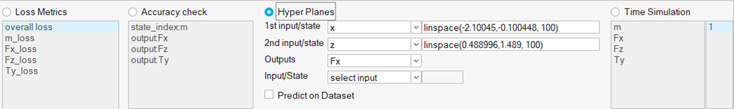

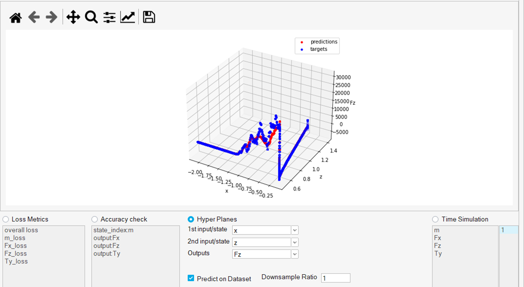

Define Hyper Planes
Select the Hyper Planes radio button.

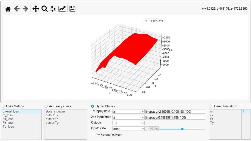

- Hyper planes: The application evaluates the trained romAI model over a range of user-defined input values and displays the output as a hyper plane. One output at a time can be displayed.
- Scatter plots of Predictions vs Targets: The application evaluates the trained romAI model into a set of points contained in a dataset file and compares the output results with the target points contained in the same dataset file through a scatter plot. Only one output at a time can be requested.

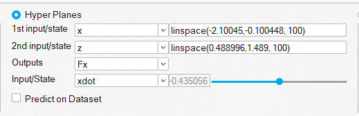

Generate Hyper Planes

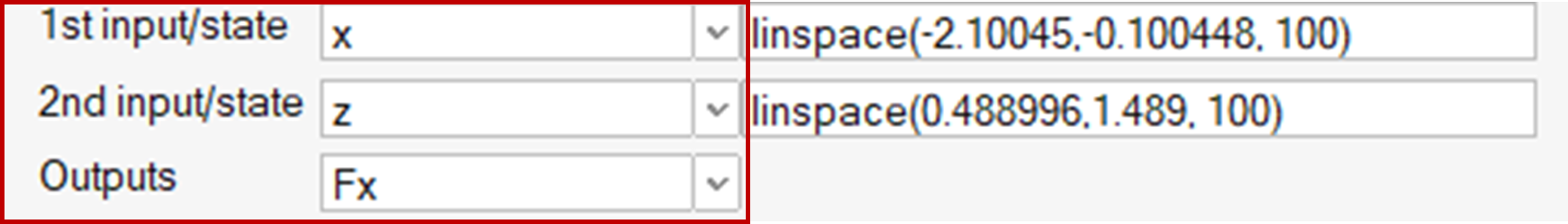

Select the 1st and 2nd inputs from the Inputs/States menu for the x-axis,
y-axis, and one output from the Outputs menu for the z-axis.

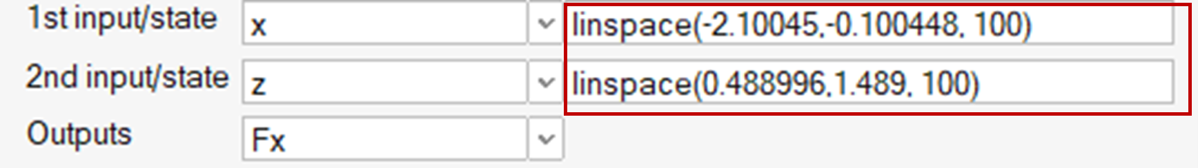

Specify the range of the x- and y-axes using Compose OML syntax.
The x/y grid is automatically created for the hyper plane. All other inputs and states are held constant.
For each additional input and state that you want to include, you can specify
the constant value for each through the menu and the slider.
After you have specified the values for all the inputs and states, the hyper planes are updated automatically.
The axes are labeled with respect to the names of the selected inputs and states and output.

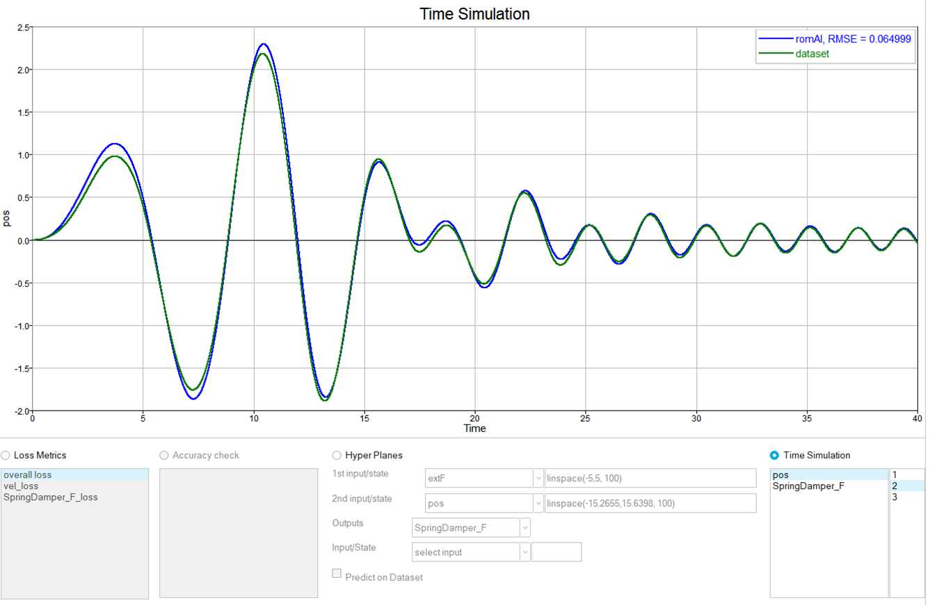

Time Simulation Tab
If romAI is used to generate dynamic ROMs, it is important to have a tool that easily performs preliminary time simulations to assess the accuracy of the transient behavior after the romAI model has been trained.
The Time Simulation tab has been designed to perform these time simulations in just one step.
A time simulation is triggered. After the simulation runs successfully, the plot is updated.
- Blue line: The dynamical results produced by the romAI model, given the inputs and the initial state conditions that are contained in the dataset file.
- Green line: The target time history.
- RMSE Metric: Root Mean Square Error calculated between the two signals is shown
in the legend. Note: The RMSE is calculated for the segment and output currently active.
Use the list box to select the output of the romAI model that you want to plot.
If the loaded dataset file contains multiple time histories, you can select the desired history in the segments list box beside the output list box.

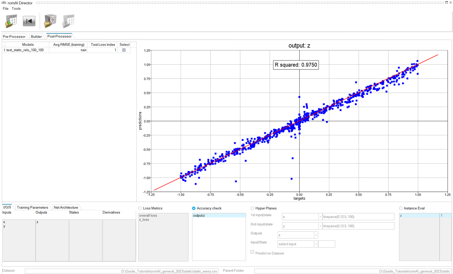

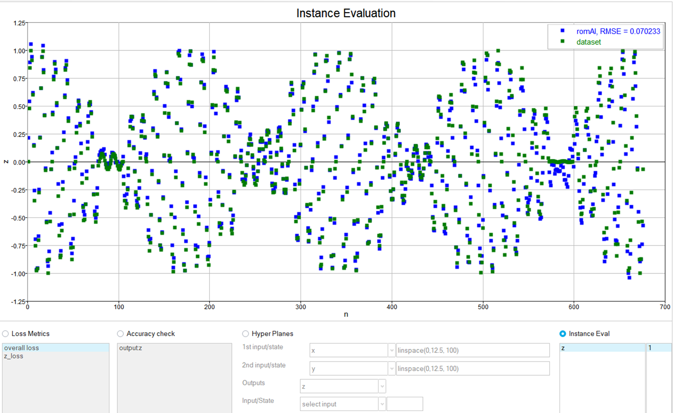

Instance Evaluation Tab
romAI can be used to generate static ROMs.
In this scenario, a time simulation is not meaningful, and it is replaced by a classical inference operation over the loaded dataset. Also, the tab name changes from “Time Sim” to “Instance Eval.”
Repeating the same steps as before, the following scatter plot is generated for a static ROM:
- Blue dots: The static results produced by the static romAI model, given the inputs contained in the dataset file.
- Green dots: the target results.
- RMSE Metric: Root Mean Square Error calculated between the romAI and dataset instances. Note: RMSE is calculated for the segment and output currently active.
Report Generation
The report generation tools can be accessed from Tools menu.
- Loss Metrics
- Accuracy Checks
- Time Simulation or Instance Evaluation
The report is saved in a folder with following syntax: <model_name>_report. Also, the folder location is displayed at the end of report generation.

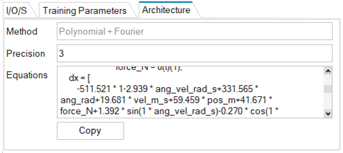

Architecture (SINDy)
When you use the SINDy method, the Architecture tab contains the approximate system equation.
When you have created a model using the SINDy method, you automatically get access to the approximate system equation. You can copy the formula and reuse it from the Architecture tab.
Depending on the precision set, the coefficient is updated with the corresponding digits.
This feature is useful for creating smarter and more robust control system algorithms.
