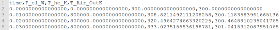

CSV Dataset File
The .CSV header determines the type of ROM, static or dynamic, that can be generated.
If the first column name is “time,” romAI can be used to generate a static or dynamic ROM. Otherwise, only a static ROM can be generated.
Hence, the first few lines of a .CSV file typically look like the following two examples:

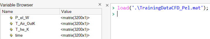

MAT Dataset File
The variables contained in the .mat file determine the type of ROM, static or dynamic, that can be generated.
If a variable called “time” exists, romAI can be used to generate a static or dynamic ROM. Otherwise, only a static ROM can be generated.
The following are two examples of .MAT files.
The variables contained in the .MAT file must be column or row vectors with the same number of elements.

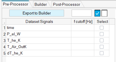

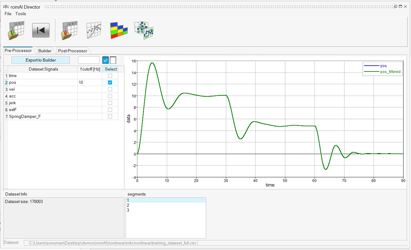

After the dataset file has been loaded, the Signal Table is populated as follows:
Select Data
All data from the loaded dataset file is listed in the Signal Table.
To select a signal, click the check box in the same row of the signal name. To select all
the signals, click the Select All
button. It
plots all the signals on the window.
To deselect all the signals, click the Select None
button

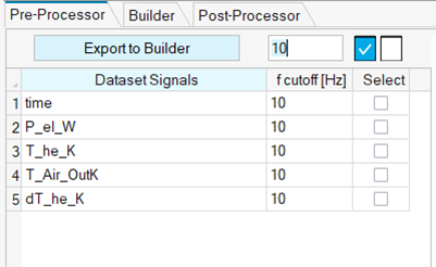

Filter Data
Data can be filtered through a low pass filter with a cutoff frequency that is specified in the Edit box.
Press Enter after entering the cutoff frequency value. This filter will be applied to all the signals in the table.
To filter a signal, enter the filter frequency in the f cutoff [Hz] column of that signal. The plot is refreshed automatically and shows the filtered and the baseline data.
To revert the filtering, delete the cutoff frequency value and press Enter. To revert filtering from multiple selected signals, delete the frequency value from filter entry on the top of the table and press Enter.

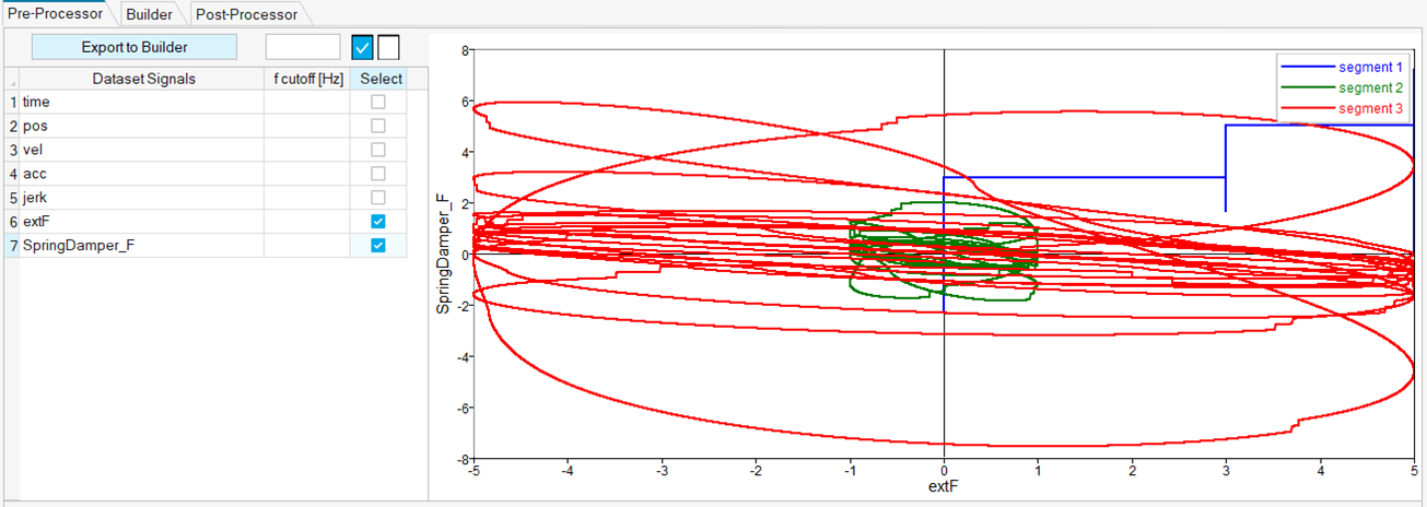

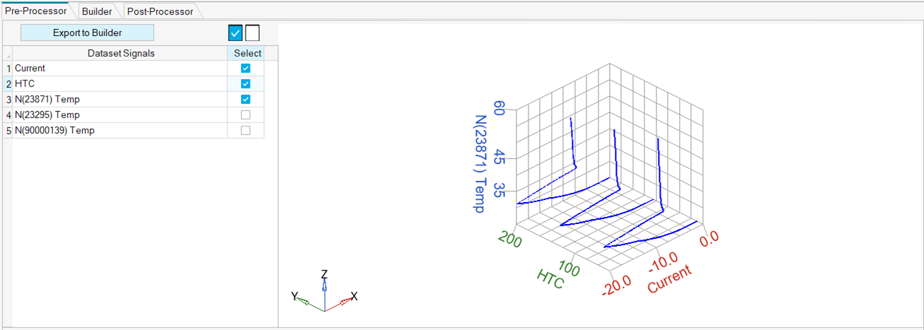

Plot Data
All data that is listed in the Signal Table can be plotted.
If labels are repeated, they are plotted only once.
To generate plots, select the check box in the same row of the signal name.

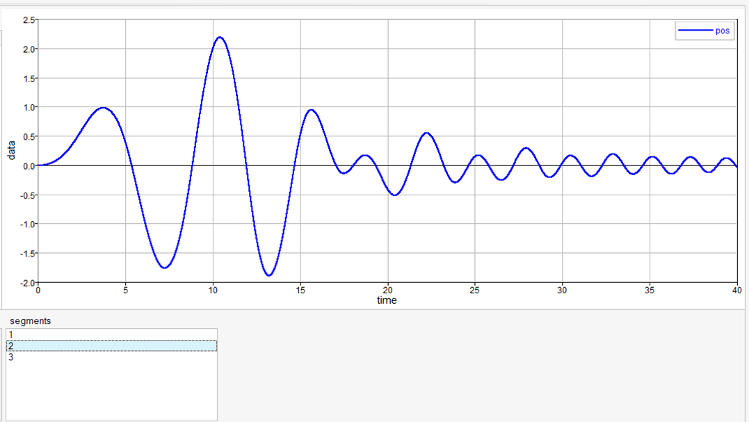

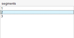

If the time vector is not monotonically increasing, the data is split into segments. The segments can be selected using the segments list box in the panel area.
Segments let you view different data segments in the plot.

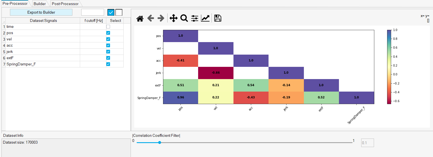

Heat Map
Heat Map can help you choose the input features for the model.
It provides the correlation coefficient values of signals among each other. To plot heat
map, click on the Heat Map
icon in the ribbon. When you click on the Heat
Map icon, the icon is deactivated. The Correlation Coefficient slider
can be used to filter the most correlated features based on the slide value. The slider
value ranges from 0 to 1 where 1 indicates 100 % correlation. The slider value filters
both positive and negatively correlated values.
To go back to the 2D plot icon, click on the 2D plot
icon

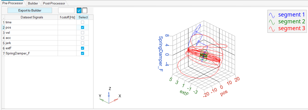

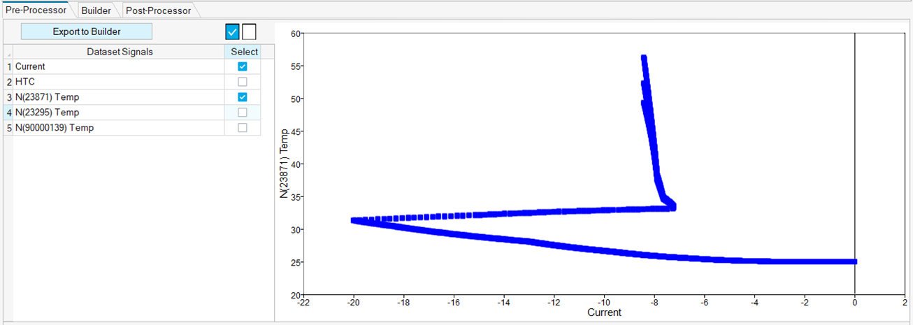

Domain View
Check the variation of a signal with other signals.

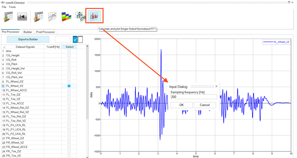

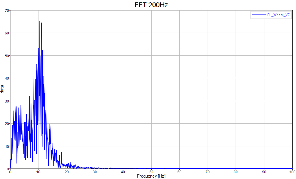

Using the single-sided normalized Fast Fourier Transformation, you move from the time domain visualization of the signal to the frequency domain and thus can explore its frequency content and identify any periodic phenomena.
This can also help to properly select the filter cutoff frequency by making sure you do not cut off frequencies of importance.
Click the Transformation icon and then set the sampling frequency.
