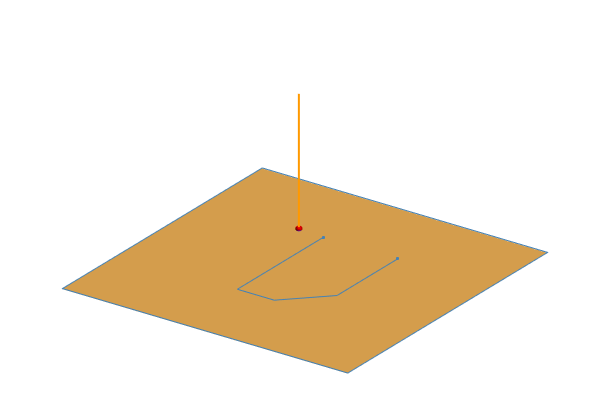

Figure 1. 3D view of an RG58 shielded cable illuminated by a monopole above an infinite ground plane.
