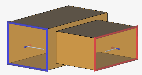

Figure 1. The waveguide port is indicated by a blue border. A waveguide port containing
a waveguide source, is indicated by a red border.
