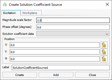

Figure 1. The Create Solution Coefficient Source dialog.
- In the Magnitude scale factor field, specify the scaling factor.
- In the Phase offset (degrees) field, specify the phase (in degrees) to be added to the phase of the currents.
- In the Solution coefficient data field, specify the solution coefficient data to be used to define the solution coefficient source.
- In the Position field, specify where the source is to be placed.
- In the Label field, add a unique label for the solution coefficient data source.
- Click the Create button to create the solution coefficient source and to close the dialog.
