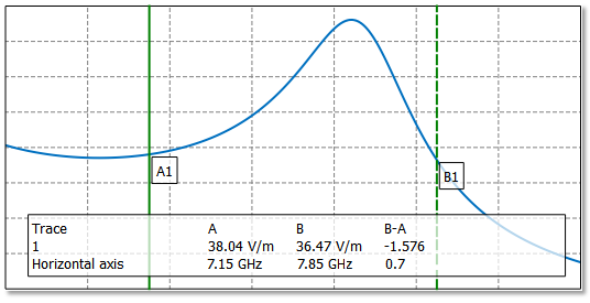

Add a cursor table to the graph.
On the Measure tab, in the
Measurement group, click the
Cursor table icon.
Figure 1. A Cartesian graph with cursor table.
Note: The table contains the data for the displayed points as well as the difference (indicated by B-A).Tip: If you move the cursor outside of the visible region of a graph, a handle appears to retrieve the cursor. -
