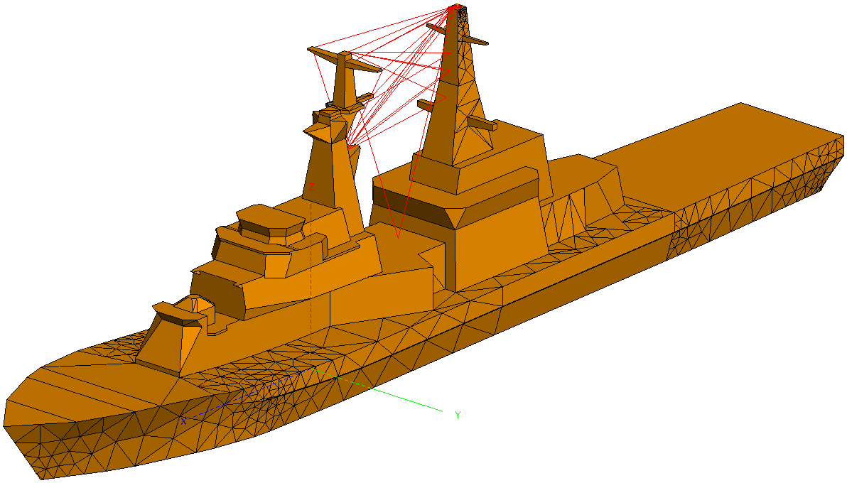

Figure 1. UTD modelling of cross-coupling on the superstructure of a modern naval vessel.

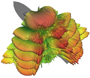

Multiple reflections, edge/wedge and corner diffraction and creeping wave effects on curved surfaces are considered. Insight into the propagation of rays are provided in POSTFEKO during post-processing. Currently, the numerical formulation of the UTD only allows it to be applied to flat polygonal plates with minimum edge lengths in the order of a wavelength, where surface curvature is not considered. A single canonical circular cylinder can be included in the model. Creeping waves are only considered on the cylinder. The UTD is well suited to the analysis of ships at radar frequencies but less appropriate for analysing complex objects with curved surfaces (such as automobiles).Figure 2. Analysis of the transmission patterns of an X-band radar mounted on a ship.
