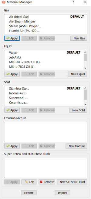

Set a Material as a Default
Materials are grouped under five types: Gas, Liquid, Solid, Emulsion Mixture, and Super-Critical Multiphase. If the default material is listed under any of these groups, click the name of the material to assign DEFAULT to it.
Define New Material in Gas, Liquid, or Solid Phase
- New Gas if the material is gas
- New Liquid if the material is liquid
- New Solid if the material is solid
- New Mixture if the material is emulsion mixture, and so on.

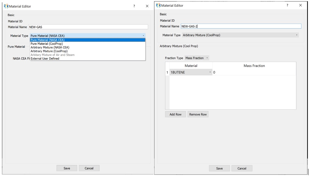

In the New Gas and New Liquid menus, many materials are listed under the following headings:
- Pure Material (NASA CEA)
- Pure Material (CoolProp)
- Arbitrary Mixture (NASA CEA)
- Arbitrary Mixture (CoolProp)
- Pure Incompressible Material (CoolProp)
- Mass Based Incompressible Material (CoolProp)
Select one of these materials, and all fluid and thermal properties (density, viscosity, specific heat, conductivity, and so on) are used from the NASA CEA database or from the CoolProp database, based on your selection.
If Arbitrary Mixture is selected, provide the Mass Fraction or Mole Fraction.

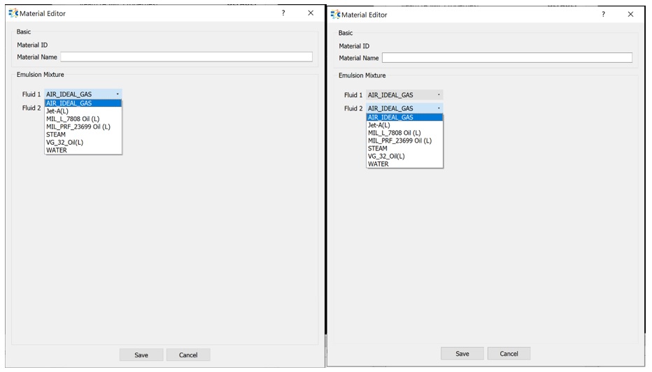

Define a New Mixture

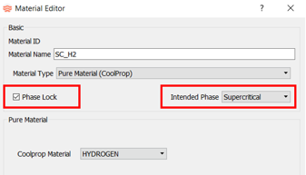

Coolprop must be used if the fluid is expected to change phase (gas-liquid) or is in the super critical range. Coolprop is a good choice for models using refrigerants or super critical fluids (CO2 or H2). Coolprop does not use the ideal gas assumption, and the compressibility factor, z, from Coolprop is used to modify the Flow Simulator equations that are based on the ideal gas equation for density.

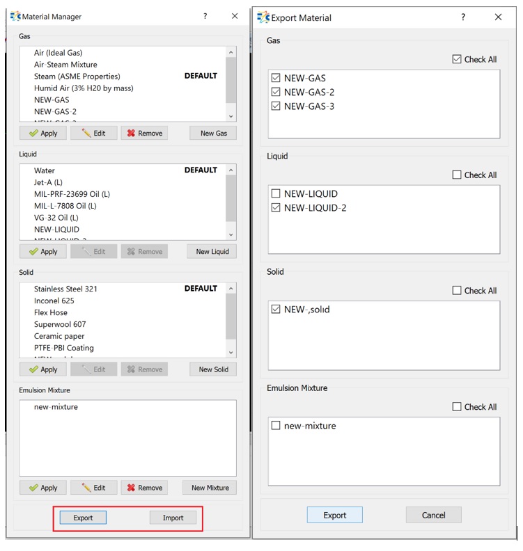

Import/Export Material Property
- Check All
- Exports all materials under that phase.
