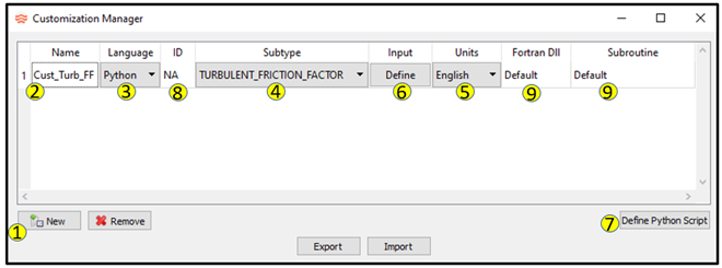

Custom Correlations in the Graphical User Interface (GUI)
- Create the custom item in the Customization Manager.
- Select the custom item from the element properties editor.

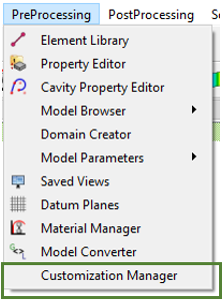

From the PreProcessing menu, select the customization manager.
Create a Custom Item
- Click New to create a new custom item.
- Give the item a name; no spaces allowed in the name.
- Select the programming language: Python or Fortran.
- Select the subtype for the custom item.
- Select English or SI units to control the units of variables passed between the custom code and the Flow Simulator solver.
- Define the unique inputs for the custom items. These can be used to add
inputs for each element that uses this custom item. These variables are
added to the argument list for the Python and
Fortran custom routines. No spaces are
allowed in the names.
Figure 3.
- If Language=Python, write the Python code. Use the Restore button to update the Python code template that is supplied.
- If Language=Fortran, a unique ID can be given so that multiple items of the same subtype can be programmed in the same Fortran subroutine. The other option is to use a unique subroutine name for each item.
- If Language=Fortran, a unique DLL and subroutine names can be given. “Default” means the solver uses customize.dll and the subroutine names are found in the fs_custom_lib.f example file.
- Use Export to write a file containing all custom items in the current model.
- Use Import in another model to read all custom items into the model.

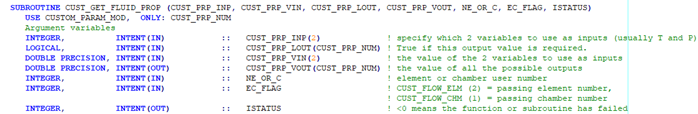

The comments in the file describe the subroutine arguments. The arguments are the typical values needed by the correlation. The arguments also include an array containing the user-defined inputs. The order of the inputs in the array are the same as the user defined inputs in the customization manager.
- CUST_GET_SET_REFERENCE_CONDITION
- CUST_GET_FLUID_PROP
- <FlowSimulator_install_folder>\Resources\Customize\reference\custom_interface_mod.f90
- custom_param_mod.f90
CUST_GET_SET_REFERENCE_CONDITION is based on the Flow Simulator controllers and can be used to retrieve (gauge or GET) and manipulate (SET) many items in the model.
CALL CUST_GET_SET_REFERENCE_CONDITION (GET_MODE, ELEMENT_TYPE, ELEM, IDX, "NONE", 0, 0, "PS", PS, ISTATUS)CALL CUST_GET_SET_REFERENCE_CONDITION (GET_MODE, ELEMENT_TYPE, ELEM, IDX, "NONE", 0, 0, "AREA", AREA, ISTATUS)CUST_GET_FLUID_PROP retrieves fluid properties based on the pressure and temperature supplied.
CUST_PRP_INP(1) = CUST_PRP_P
CUST_PRP_INP(2) = CUST_PRP_T
CUST_PRP_VIN(1) = PS
CUST_PRP_VIN(2) = TS + 459.67
CUST_PRP_LOUT = .FALSE.
CUST_PRP_LOUT(CUST_PRP_CON) = .TRUE.
CALL CUST_GET_FLUID_PROP(CUST_PRP_INP, CUST_PRP_VIN, CUST_PRP_LOUT, CUST_PRP_VOUT, ELEM, CUST_FLOW_ELM, ISTATUS)
K = CUST_PRP_VOUT(CUST_PRP_CON)The subroutine CUST_FILL_OUTPUT_STRING writes custom correlation information to the element section in the .res file. The arguments are:

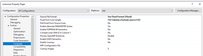

The INTEL Fortran compiler (v19.0.4.245) was used for development testing of this feature. Other compilers and versions may work but have not been tested. Compiling and linking should be done for 64-bit to be compatible with Flow Simulator. The fs_custom_lib.f uses the Fortran fixed format but with lines up to 132 columns, so use these compiler options. An example in Visual Studio:

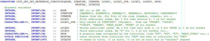

- cust.get_set_reference_condition
- cust.get_fluid_prop
The arguments are like the Fortran code except that the returned values are not in the argument list.
propval = cust.get_set_reference_condition (mode, itemtype, itemnum, prop, locat1, locat1_str, locat2, locat3)
mode = GET (1) or SET (2)
itemtype = CHAMBER=3, ELEMENT=4, THERMAL=7, GENERAL=1, MISSION=2, COMPONENT=8
itemnum = Number from the .flo file of the item (chamber, element, etc..)
prop = A property name recognized by the controller (like "PT", "PS", "TT", "MDOT_TOTAL" etc..)
locat1 = First additional index. Ex: 5 for tube station 5, 0 if not needed
locat1_str = Only needed if itemtype=7 (Thermal). Then use "TNODE", "CDUCR", "CVECR", "RADTR", "HEAT_FLOW". "NONE" if not needed.
locat2 = Second additional index. Ex 2 for tube wall side 2, or 4 for TNODE 4, 0 if not needed
locat3 = Third additional index. Ex "2" for ?, 0 if not needed, etc..
propval = value returned from controller for "GET" and sent to controller for "SET"pstatic = cust.get_set_reference_condition (cust.GET_MODE, cust.ELEMENT_TYPE, int(elem), "PS", int(idx), "NONE", 0, 0)area = cust.get_set_reference_condition (cust.GET_MODE, cust.ELEMENT_TYPE, int(elem), "AREA", int(idx), "NONE", 0, 0)propval = cust.get_fluid_prop (inp_type_1, inp_val_1, inp_type_2, inp_val_2, out_type, itemnum, ec_flag)
