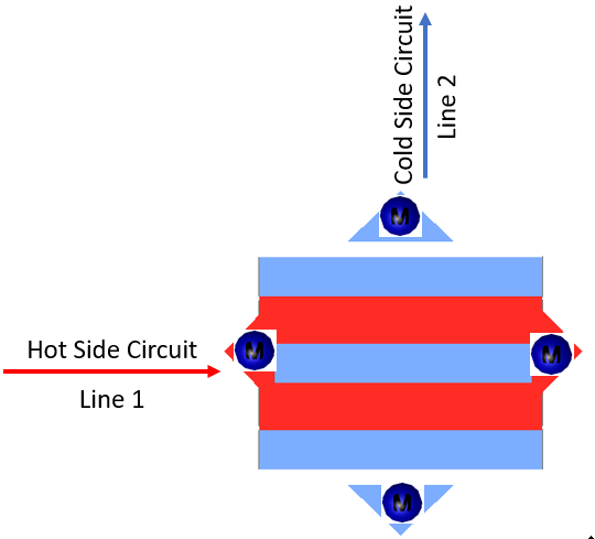

  • The Hot Side circuit must get connected to Line 1 (Indicated by Red Color part of Component Image) and Cold Side circuit get connected to Line 2 (Indicated with Blue Color part of Component Image) as shown in the image below.
    Figure 3.

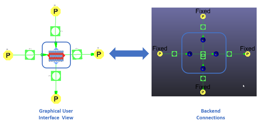

  • You can choose to model additional inlet and outlet losses using the separate Discrete Loss/Tube Element upstream and downstream of heat exchanger respectively.
  • The Hot/Cold Side circuit line must be connected with either compressible or Incompressible set of elements. Mixing of elements sets for a Hot/Cold side circuit line is not allowed. Below Table represents some modeling/allowable scenarios.

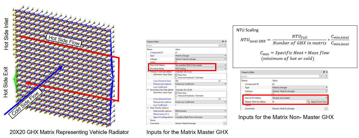

GHX components can also be arranged in a matrix to discretize temperature changes and boundary conditions. For example, a vehicle radiator can be modeled with a 20 by 20 array of GHX components to show how coolant temperatures change through the system.
Figure 4.

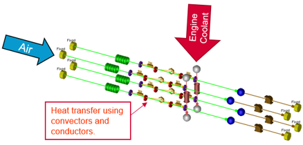

Flow Simulator can also be used for Heat Exchanger design. For heat exchanger design a detailed representation of the heat exchanger is required. The example below shows flow elements representing the cold and hot side with thermal network resistors connecting the sides. Heat exchanger performance can be predicted from such a model.
Figure 5.

Generic Heat Exchanger Matrix
Any number of GHX components can be added to a matrix to discretize the pressure loss and thermal results. One of the GHX components in the matrix must be declared the matrix master. It does not matter which component is declared the master. The master is given the overall pressure loss and heat transfer performance for the entire heat exchanger. All the other GHX components in the matrix use the number of the master components to identify all components that are part of the matrix. The pressure loss is distributed evenly between all GHX components in the series. The heat transfer is discretized using two methods:
  1. NTU scaling.
    N T U l o c a l   G H X =   N T U f u l l N u m b e r   o f   G H X   i n   m a t r i x * C m i n , t o t a l C m i n , l o c a l MathType@MTEF@5@5@+= feaahGart1ev3aqatCvAUfeBSjuyZL2yd9gzLbvyNv2CaerbuLwBLn hiov2DGi1BTfMBaeXatLxBI9gBaerbd9wDYLwzYbItLDharqqtubsr 4rNCHbGeaGqiVu0Je9sqqrpepC0xbbL8F4rqqrFfpeea0xe9Lq=Jc9 vqaqpepm0xbba9pwe9Q8fs0=yqaqpepae9pg0FirpepeKkFr0xfr=x fr=xb9adbaqaaeGaciGaaiaabeqaamaabaabaaGcbaaeaaaaaaaaa8 qacaWGobGaamivaiaadwfapaWaaSbaaSqaa8qacaWGSbGaam4Baiaa dogacaWGHbGaamiBaiaacckacaWGhbGaamisaiaadIfaa8aabeaak8 qacqGH9aqpcaGGGcWaaSaaa8aabaWdbiaad6eacaWGubGaamyva8aa daWgaaWcbaWdbiaadAgacaWG1bGaamiBaiaadYgaa8aabeaaaOqaa8 qacaWGobGaamyDaiaad2gacaWGIbGaamyzaiaadkhacaGGGcGaam4B aiaadAgacaGGGcGaam4raiaadIeacaWGybGaaiiOaiaadMgacaWGUb GaaiiOaiaad2gacaWGHbGaamiDaiaadkhacaWGPbGaamiEaaaacaGG QaWaaSaaa8aabaWdbiaadoeapaWaaSbaaSqaa8qacaWGTbGaamyAai aad6gacaGGSaGaamiDaiaad+gacaWG0bGaamyyaiaadYgaa8aabeaa aOqaa8qacaWGdbWdamaaBaaaleaapeGaamyBaiaadMgacaWGUbGaai ilaiaadYgacaWGVbGaam4yaiaadggacaWGSbaapaqabaaaaaaa@740C@
  2. Evenly distribute Q.
    Q is calculated for the total HX and distributed evenly to each.
Note: Bi-Linear interpolation is employed between the values in the table to determine Y Values. If X-Value is less than its first value entry in the table, the first Y-Value entry is used. If the X-Value is greater than its last value entry in the table, the last Y-Value entry is used. Flow Simulator does not do any extrapolation if the values are outside the prescribed input limits.
