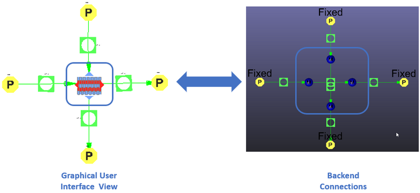

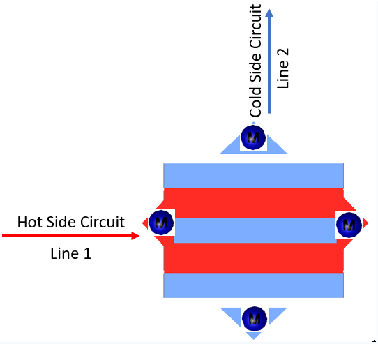

Important modeling aspects when using the heat exchanger components include:
  • The Hot Side circuit must be connected to line 1 (red part in the image below) and the Cold Side circuit must be connected to line 2 (the blue part in the image below):
    Figure 3.
  • The Hot/Cold Side circuit line must be connected with either compressible or Incompressible set of elements. Mixing of elements sets for a Hot/Cold side circuit line is not allowed. Plate Fin Heat Exchanges supports following fin configurations. The Heat Transfer Coefficient and Friction factor for various configurations are calculated based on public literature which are provided in theory manual below.

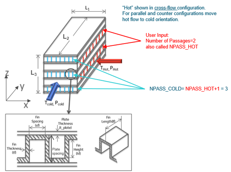

Plate Fin Heat Exchanger Element Inputs
Figure 4. Plate Fin Heat Exchanger Dimension Details
Table 1. Element-Specific Plate Fin Heat Exchanger Component Input Variables
Index Field Description
1 Length in X Direction (L1) Dimensions of Heat Exchanger (Refer Image Above)
2 Length in Y Direction (L2) Dimensions of Heat Exchanger (Refer Image Above)
3 Length in Z Direction (L3) Dimensions of Heat Exchanger (Refer Image Above)
4 Number of Passages (NPASS) Number of Hot Passages
5 Flow Configurations Configuration of Heat Exchanger
  1. Parallel Flow
  2. Counter Flow
  3. Cross Flow
6 Fin Configurations Fin configurations
  1. Plain Rectangular
  2. Plain Triangular
  3. Offset Fins
  4. Wavy Rectangular
  5. Wavy Triangular
  6. Louver Rectangular
  7. Louver Triangular
  8. User-defined Rectangular
  9. User-defined Triangular
7 Fin Material Fin Material. By default, two Standard Materials are listed.
  • Stainless Steel
  • Inco 625
Any Custom Material defined using the Material Manager under the solid category is available for selection apart from the above-mentioned standard materials.
8 Fins per Inch No of Fins per Inch
9 Plate Spacing (H) Distance between Plates
10 Fin Thickness (t) Thickness of Fin (Refer to Image Above)
11 Offset Length (w) Offset Length (Used for Offset Fin Configurations)
(Refer Image in Theory Sections)
12 Wave Length (p) Wavelength (used for Wave Fin Configurations)
(Refer to Image in Theory Sections)
13 Louver Pitch (Lp) Louver Pitch (used for Louver Fin Configurations)
14 Louver Height (Lh) Louver Height (used for Louver Fin Configurations)
15 Plate Material Plate Material. By Default, two Standard Materials are listed.
  • Stainless Steel
  • Inco 625
16 Plate Thickness Plate Thickness (Refer to Image Above)
17 Bar/end Plate Thickness End Plate Thickness
18 Colburn J factor coefficient A J_ACOEFF Coefficient A for Colburn J factor (Refer to Equations in Theory Manual)
19 Colburn J factor coefficient B J_BCOEFF Coefficient B for Colburn J factor (Refer to Equations in Theory Manual)
20 Friction factor coefficient A F_ACOEFF Coefficient A for Friction F factor (Refer to Equations in Theory Manual)
21 Friction factor coefficient B F_BCOEFF Coefficient B for Friction F factor (Refer to Equations in Theory Manual)

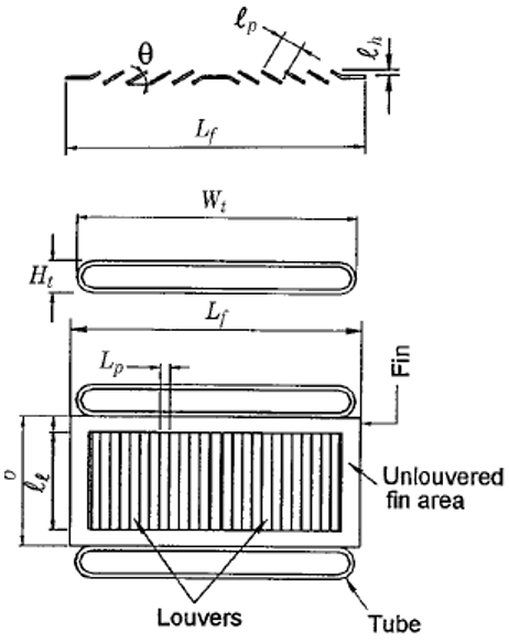

Louver Fins:
j = 0.249 R e l p - 0.42 l h 0.33 l l f h 1.1 f h 0.26
R e d h < 900     = >   f = 5.47 R e l p - 0.72 l h 0.37 l l f h 0.89 l 0.2 f h 0.23
R e d h > 900     = >   f = 0.494 R e l p - 0.39 l h 0.33 l l f h 1.1 f h 0.46
Lp - louver pitch
Ll - louver length
Fh - fin height (plate spacing)
Lh - louver height

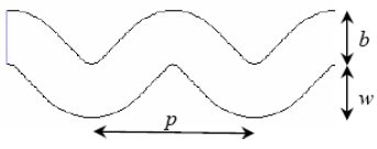

Wavy Fins:
10 4 < R e < 10 ^ 5     = >     f = 0.4 8 R e - 0.36 2 b p 1.5 ;     j = 0.4 R e - 0.36 2 b p 0.75
600 < R e < 2300   = >     f = 5 j ;     j = 0.4 R e - 0.4 2 b p 0.75
