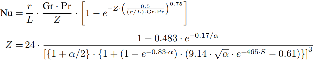

r = Characteristic length, Fin hydraulic radius (2LS / 2L+S).
α = Channel Aspect Ratio (S/L).
For Spacing > 2 in, the correlation is given by (Ref. 3):
Where,
S = Characteristic length (spacing between the fins).
Gr = Grashoff number based on the characteristic length (S).
Pr = Prandtl number at film temperature (TFluid-Stream + TWall / 2).
The heat transfer coefficient from Nusselt number is obtained as:
Where, k = Thermal conductivity of the fluid at film temperature (TFluid-Stream + TWall / 2).
