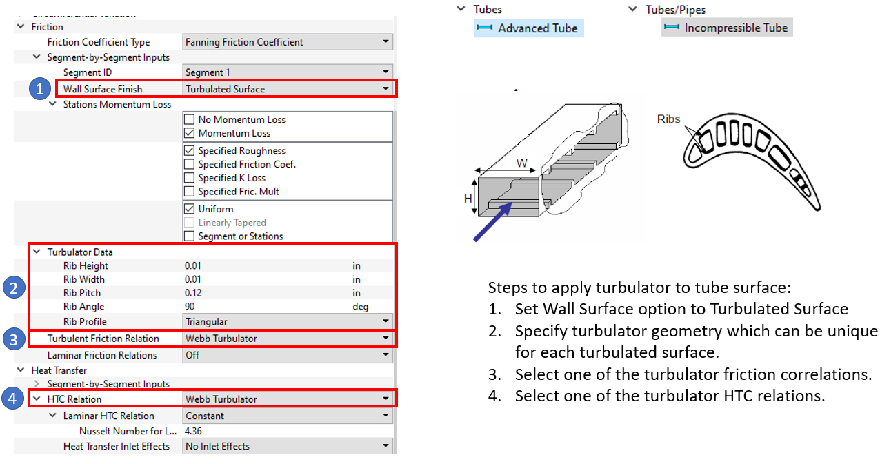

Turbulated Tube
- Type
- Mixed Laminar-Turbulent Duct Nu
- Subtype
- Turbulated Tube

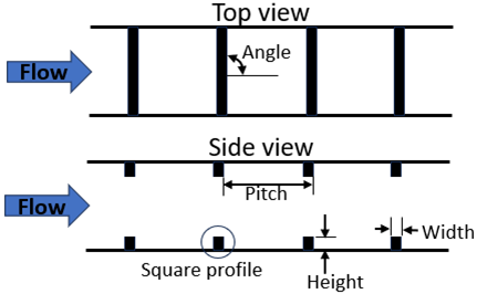

| 5 | Rib Height (RIB_HEIGHT) | Perpendicular distance from the wall surface to the tip of the rib. |
| 6 | Rib Width (RIB_WIDTH) | Distance between the sides of the rib. Usually, this is the
same as the Rib Height and most correlations assume it is the
same. If AUTO, the width will be set equal to the height. |
| 7 | Rib Pitch (RIB_PITCH) | The distance between the ribs in the flow direction. |
| 8 | Rib Angle (RIB_ANGLE) | The angle between the rib and the flow direction. 90 degrees means the rib is perpendicular to the flow. Typical angles are between 45 and 90 degrees. |
| 9 | Rib Profile (RIB_PROFILE) | The rib shape. 1: Circle 2: Semicircle 3: Triangular 4: Square (default) |
