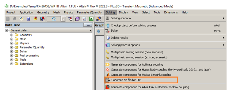

Create automatically input file by using command Generate zip file for PBS in Flux

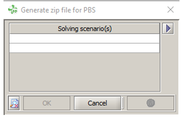

From Flux 2022.3, generate the input file for PBS from a Flux project:
When selecting this command, the following dialog window is displayed:
You have to select the scenarios to solve with PBS.
The zip file *.zip is created in the working directory, with the Flux project *.FLU and the Python *.py inside.

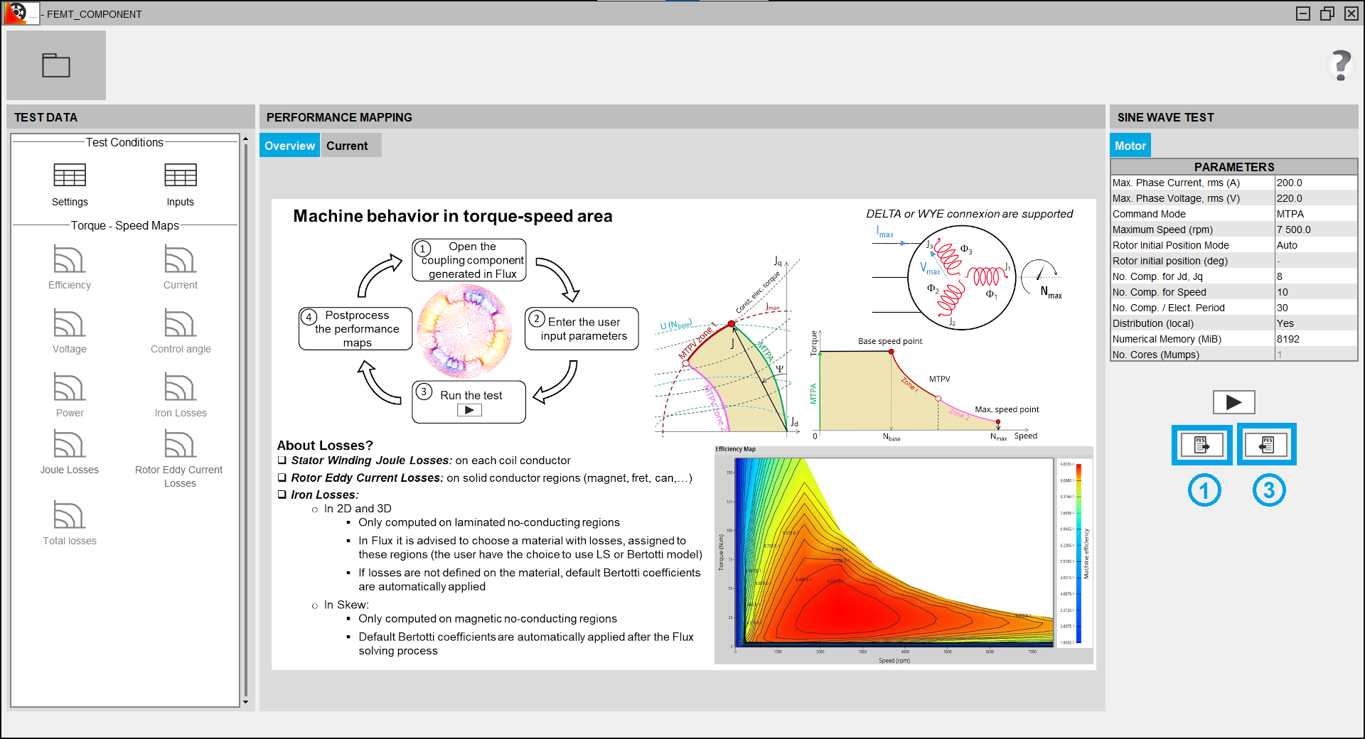

Create automatically input file in Flux e-Machine Toolbox
From Flux 2022.1, is now possible to run tests via PBS in FeMT to save computation time.
- In FeMT, export the necessary files for PBS by clicking on button 1 in the image below;
- In PBS, run the computation through a cluster;
- In FeMT, import the PBS result by clicking the button 3 in the image below.
