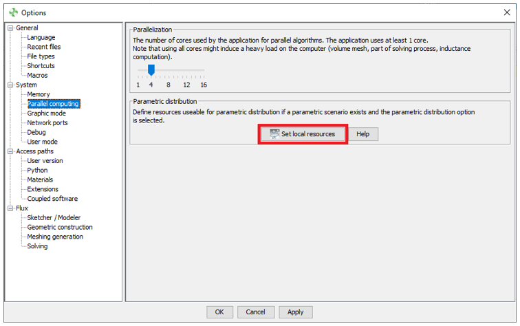

- The Distribution Manager may be started in the Supervisor's
options, in the Parallel Computing
menu, in the section Distributed Computing and then
click on the button Set local resources as shown below:
Figure 1. The supervisor's options allow the user to set the parametric distribution.

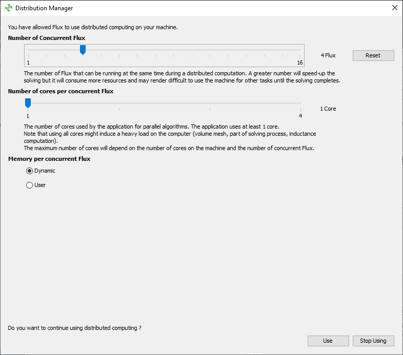

- An additional window Distribution Manager should appear and is asking to allow some resources (Number of secondary Flux in parallel) for the parametric distribution, click on Allow;
- The Distribution Manager then asks for the
Number of concurrent Flux as follows:
Figure 2. The Distribution Manager asked for the Number of Concurrent Flux.
This number is directly linked to the number of cores available on the machine, the numbers of varying parameters are automatically distributed over the number of concurrent Flux. The secondary Flux is automatically run in mono core mode but may be changed by using the slider Number of cores per concurrent Flux.

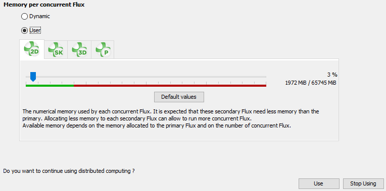

- Then define the Memory per concurrent Flux.
- Dynamic (option by default)
- User (possibility to define the memory for
each concurrent and independently for each modules 2D/ Skew / 3D /
PEEC):
- The numerical memory defined is used by each concurrent Flux
- It's excepted that these secondary Flux need less memory than the primary
- Allocating less memory to each secondary Flux can allow to run more concurrent Flux
- Available memory depends on the memory allocated to the primary Flux and on the number of concurrent Flux
- Finally, click on Use to complete the parametric distribution
