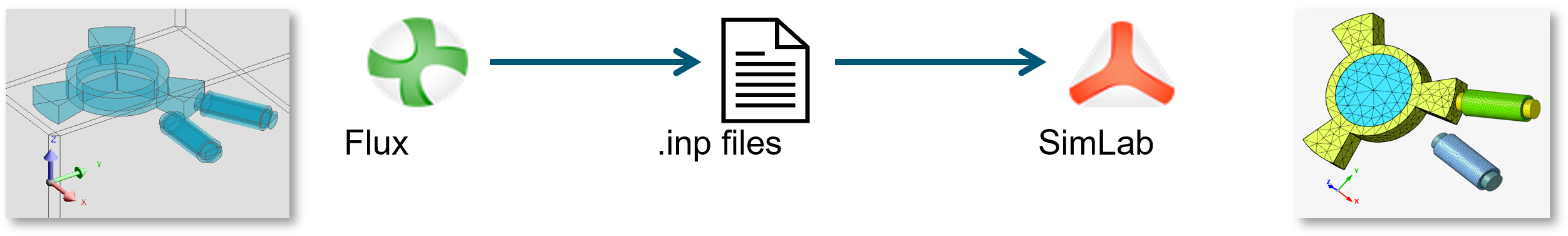

Since several releases of Flux, the Flux teams works a lot to integrate the various applications in SimLab. The main goal of this integration are the homogenization of the easy GUI of all Altair's softwares, and the easy to use to be able to do multiphysics modeling (NVH, Thermal, Electromagnetic, Electrostatic...).
To ensure a smooth transition for Flux users to SimLab, we are working on an export of Flux projects in an Abaqus format. The resulting file can then be imported into SimLab.
We're working hard to convert as much of a Flux project as possible to a SimLab database, but there will be some limitations.
The work is in progress but the functionality is already available in Flux 2025 (export part) and SimLab 2025 (Import part) with several limitations.

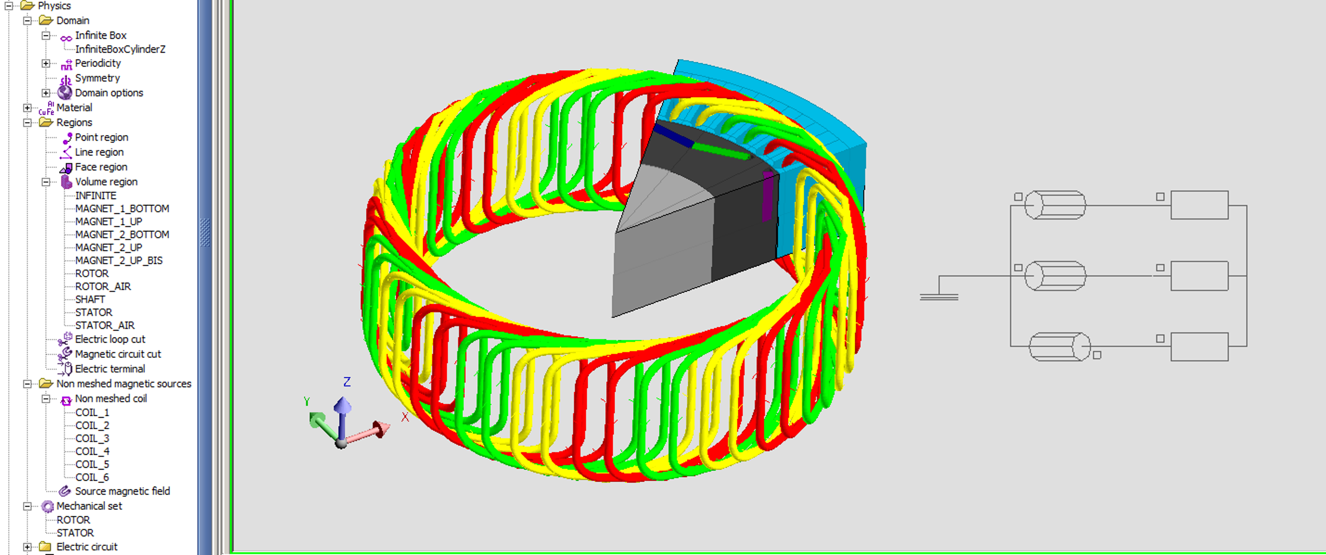

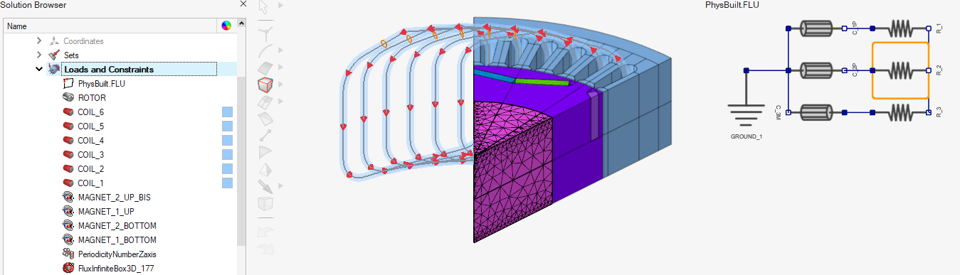

| Flux | ![]() |
| SimLab | ![]() |
- Exporting a Flux project produces a “Ready to solve” project in SimLab. As a result, the simulation results obtained in Flux are not migrated into SimLab, and you will have to re-solve the project from SimLab
Parametrization methods are radically different between Flux and SimLab and no direct correspondence is possible between these 2 methods. As a consequence, if a Flux project contains parametrized geometry, after the Abaqus export from Flux and the Abaqus import to SimLab, the geometric parametrization is lost

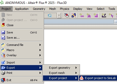

Workflow
- Open the Flux project which you want export
- In the menu Project select
- Choose the Output directory
- Click on OK
→ Files are created. The main file is *.inp
Step 2 Result Step 4
CAUTION: Please note that the contents of the selected directory will be erased. This is a known issue in release 2025, which will be fixed in 2025.1. - Open SimLab

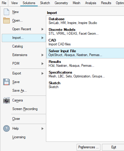

- Import the master abaqus file *.inp:
- Open the Import dialog box by selecting
- Choose the extension of the import as Flux
(*.inp) in the bottom right corner:→ the folder is filtered and only the flux_simlab_init.inp is displayed

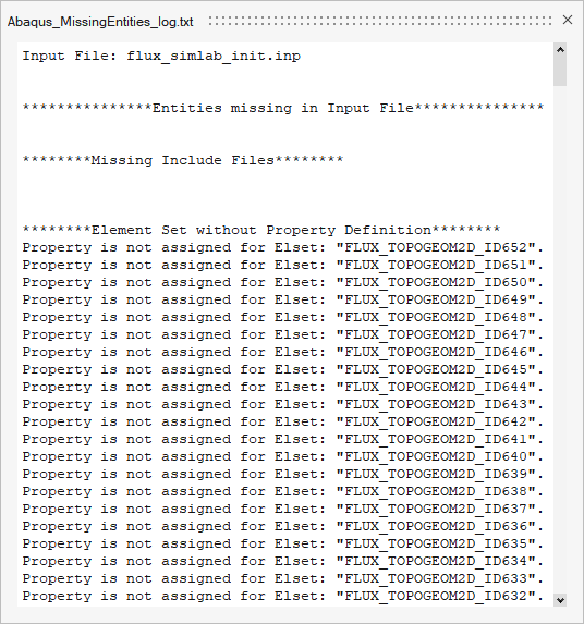

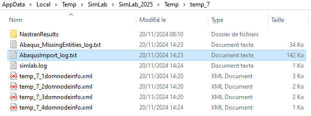

→ The log file "AbaqusImport_log.txt" is stored in the user scratch directory define in Preference of SimLab. By defaut it's:
C:\Users\"NameOfUser"\AppData\Local\Temp\SimLab\SimLab_2025\Temp\temp_x
