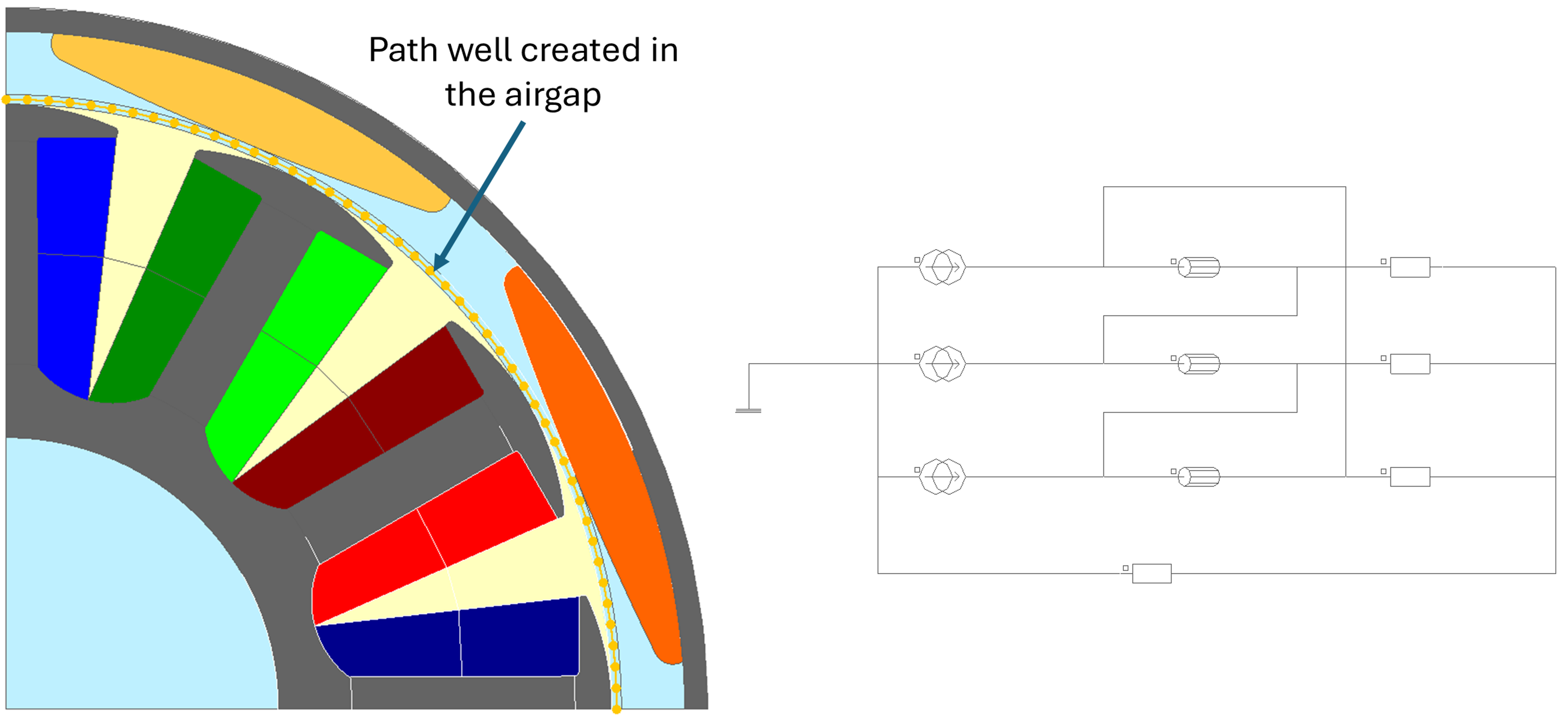

| Find Rotor
Angle
(Update) "Find_Rotor_Angle macros now also compute initial position of the motor for outer rotor motors and considers wye and delta connection in your circuit" ![]() |

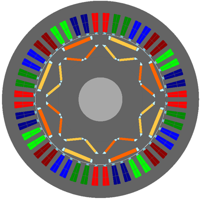

| Rotor Eccentricity
Analysis
(New) The initial geometry of the IPM is imported from FluxMotor. The example carries out the analysis of an IPM motor where the rotor is eccentered from the stator. The results are magnetic forces that can be re-injected in SimLab to compute the ERP and see the effect of this eccentricity on the NVH of the motor. |

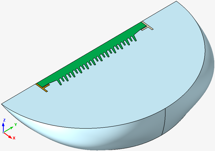

| ES3D
Insulator
(Update) The studied device is an insulator separating two conductors, one at high potential, and another one grounded. The device is in the air. The aim is to study ionized canals propagation (Streamers propagation) with "Streamer Criterion" Load. |

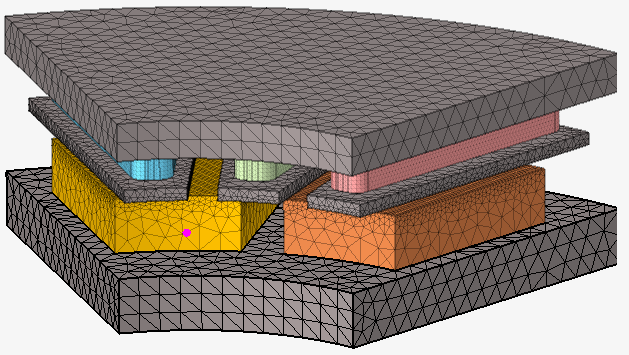

| MT3D Axial Flux
Machine
(Update) This study case is devoted to the modeling and analysis of an axial flux machine with one internal rotor and two external stators. The motor geometry and meshing description are defined by using the AFM modeling tool. |

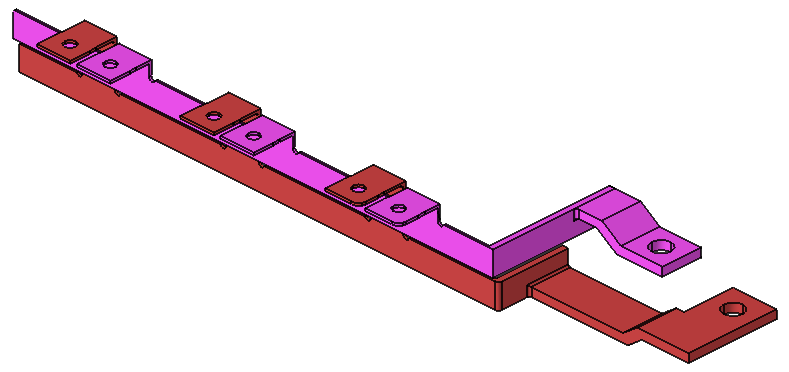

| SCAC
Busbar
(New) The device studied is a busbar. It is a copper device and the purpose is to calculate the joule losses in the geometry, and the electric current in the RL loads. |

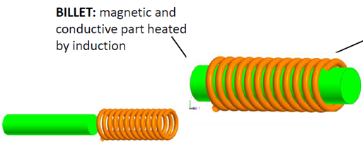

| MAC3D Induction
Heating of a Billet
(New) The studied device is composed of a mobile billet and a supply inductor. The goal is to simulate a forced cooling process at the end of heating (when the billet is out of the coil). |
