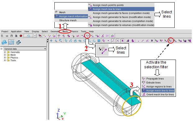

Activate the command
To activate the Assign mesh line command, which requires data selection , choose one of the methods presented in the figure below:
Note: To open a contextual menu, use the right button of the mouse. For multiple
selections, keep the Ctrl key pressed.
