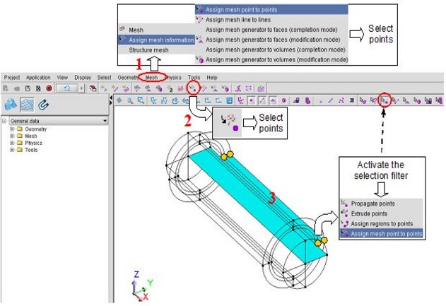

Activate the command
To activate the Assign mesh point command, which requires data selection , choose one of the methods presented in the figure below:
Note: To open a contextual menu, use the right
button of the mouse. For multiple selections, keep the Ctrl key
pressed.
