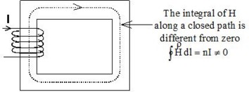

The magnetic connectivity problem appears in the case of closed magnetic circuits of high permeability (transformers…). More precisely, it appears when there is a closed path passing through several volume magnetic regions and the line integral of H is not zero along this path.
Solution: the cut concept
To overcome this problem, it is necessary that a cut be created in the magnetic circuit. This is a “mathematic cut” which means a jump in the scalar potential. The continuity of the fields B and H across the cut is obviously satisfied.

- example showing a connectivity problem
The magnetic circuit is closed
