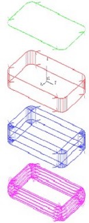

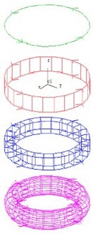

The shapes of the coils available in Flux are listed in the table below.
| Coil | Circular | Rectangular | Composed |
| line | ![]() |
| surface | |||
| volume (rectangular section) | |||
| volume (circular section) |

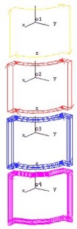

| Coil | saddle or multi saddles |
Example with 3 pairs of poles |
