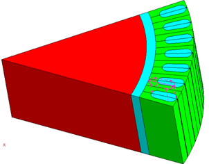

Particularity of the extrusion from an existing 2D profile
An extrusion from a sketch, doesn't achieve an assembly operation, so the object is « free ».
In contrast with direct extrusion of a face belonging to an object, an assembly operation between the obtained object and the object with the extruded face, is necessary to ensure the cycle of life of the extrusion (2geometric operations are created: extrusion + assembly).
It is introduced a limitation, the topology of extruded origin face can't be modified. It means that the contour of this face can't be modified (must keep the same number of lines, and the same lines).
But the dimensions of this face can be modify by the geometric operation previously applied on the object containing this face.
