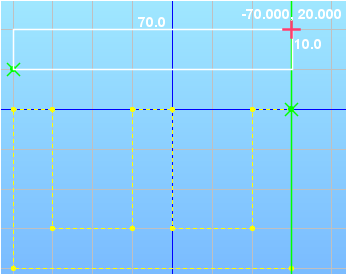

Projected lines and points
When the sketch is opened (sketcher context opened), points and lines entities of geometry already created and not belonging to the sketch, can be viewed in the sketcher. Points and lines can be projected orthogonally on the graphical view (in yellow).
These projected entities can be useful to locate and align the profile to create.
Two filters correspond to these entities:
- Display or hide the projected lines by the icon
- Display or hide the projected point by the icon
| Obtained 3D object represented in modeler context | Projection of points and lines of this object, displayed in the sketcher context |
