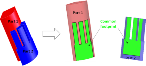

Interferences are defaults between objects. It exits 2 types of interference:
- Coincidences between objects: two objects with a common footprint
- Collision between objects: two objects with a common area (volume)
| Type of interferences | ||
| Coincidence |
| Collision |

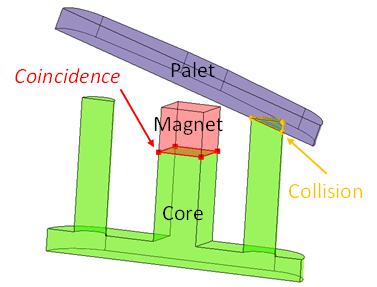

Example of interferences
Example of interferences:
- An interference of Coincidence type between two objects Magnet and Core with different physic model
- requires an assembly
- A interference of Collision type between two objects Palet and Core
- requires an user action (rotation, translation, Boolean operation …)

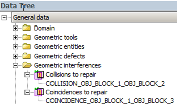

Collision detection at the import
During the CAD import:
- « Coincidence » interferences are automatically corrected with the assembly option at YES.
- « Collision » interferences are automatically detected if the option Detection collision is at YES. Collisions appear in the data tree in the node Geometric Interferences.
- If an object A is in collision with an object B and one of these objects has coincidences, the concerned objects will not be assembled. Coincidences will persist.
- To take into account the Detection of collisions option, the option of solids assembly must be Yes, otherwise it will become obsolete and no collision detection will be performed. In a second time, the user can do this manually in the modeler using the local function Detection of geometric interferences (see next block).
