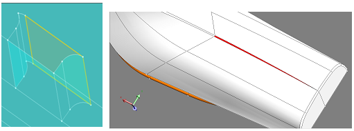

Hypertangent entities
Hypertangency means that when two lines or two faces are connected with an angle near to the tangent. This area is particularly sensitive during mesh and subject to unnecessary nodes overload. This may be a crack or a peak.
Currently it is only possible to detect these sensitive areas; there is no functionality to simplify automatically the hypertangencies. Contrariwise with the features of modeler a number of configurations can be solved by modifying the geometry without denature it.
