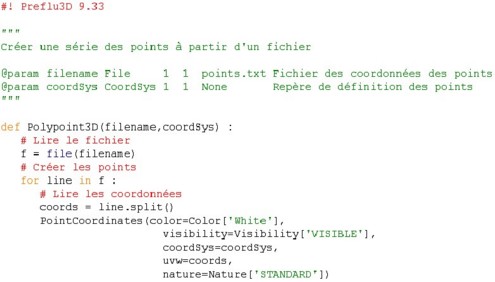

Stage 1: file explanation
The file of the macro Polypoint3D.py is presented as follows:
| Element | Function |
indication on the executable program |
parameter statement using the keyword @param |
parameter names: filename , coordSys |
PyFlux types: File , CoordSys |
minimal and maximal cardinalities |
default value points.txt keyword None |
labels of parameters |
definition of the Polypoint3D function with 2 parameters (parameters to define the file name and the coordinate system) |
creation of a variable f which takes for values the data of the filename file |
realization of a for loop to reiterate on the file lines |
creation of a variable coords which takes for values the list of strings for each file line |
creation of the points with the following characteristics:

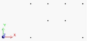

Stage 4: final result
After running the Polypoint3D macro, the user has the following 8 points in his Flux project:
(0, 0, 0), (3, 0, 0), (3, 2, 0), (2, 2, 0), (2, 1, 0), (1, 1, 0), (1, 2, 0), (0, 2, 0).
