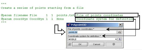

Run a macro
The user can run a macro by using the Run command from the macro contextual menu or by clicking on the corresponding icon. The dialog box associated to the types of parameters is then displayed.

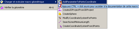

Direct access by menu
With the aim to highlight and facilitate access to the macros provided with Flux, a menu Load and run macro is implemented in each menu Geometry, Mesh Physics and Advanced.
The user has the possibility via this menu to :
- load and execute a macro
- consult the PDF documentation
- point and click on a macro in the menu, then click on the button “I”
- or point on the macro in the menu and CTRL+ right click on the macro
