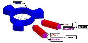

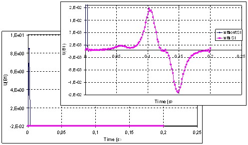

Variable reluctance speed sensor as describe in the Generic Tutorial for Flux 3D
| Finite elements description: | Circuit description: |
Results with and without SI:
