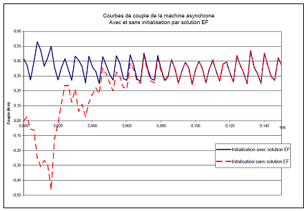

Example 1: results
The curve of the time variation of the electromagnetic torque of the asynchronous machine is represented in the figure below in the two following conditions: with or without initialization by a FE solution.
Main results:
without initialization by a FE solution (dotted lines): one can note a transient period before the curve reaches the steady state regime
with initialization by a FE solution (solid lines): the curve reaches the steady state regime faster
