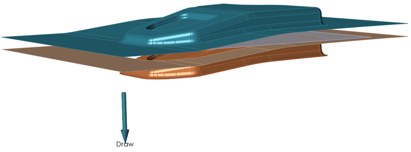

Define the Draw Direction
Define the direction for the top die or press slide to move in the model.

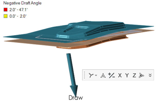

Double-click the draw-direction arrow.
Select from the options on the microdialog to change the draw direction.

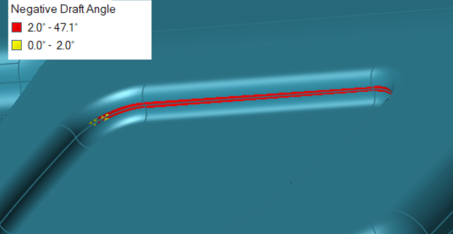

Tip: Use the legend to monitor the undercut draft angle. Avoid orientations of the model with many red areas. Yellow areas have a passable draft angle.

Microdialog Options
Select from the options to define the draw direction of the forming process.
| Icon | Description |
| Align the draw direction to a user-defined reference system. | |
Manually define the draw direction with the manipulator that appears on the model. |
| Reverse the draw direction. | |
Align the draw direction to the global X, Y or Z axes. |
Align to part |
Review the value for the the global X, Y or Z axes. |
