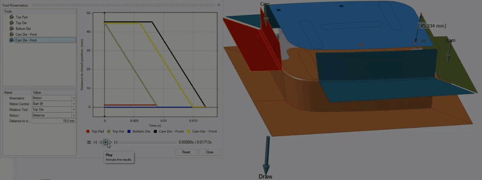

  1. On the Tryout ribbon, hover over a forming operation that you've added to your analysis.
    The options for the forming operation appear.
  2. Click the Tool Kinematics option.
    The Tool Kinematics guide panel is displayed, listing the tools and corresponding motion sequence attributes. A chart shows the motion of tools to the closed position in relationship to time. An animation toolbar allows you to preview tool motion.
    Note: The Edit Position option is not available for Gravity, Trim, and Springback operations.
Tool Kinematics Options
  1. In the Tool Kinematics guide panel, select a tool.
    The guide panel lists each tool in the operation and displays a plot of the tool's displacement to the closed position.
  2. Edit each tool's attributes as needed to set the sequence of motion for each tool.

    Bottom Die The bottom die is stationary, and all options are unavailable.
    Bottom Binder
    Kinematics: Select Follower Motion.
    Mating Tool: Displays the name of the tool that mates with the bottom binder.

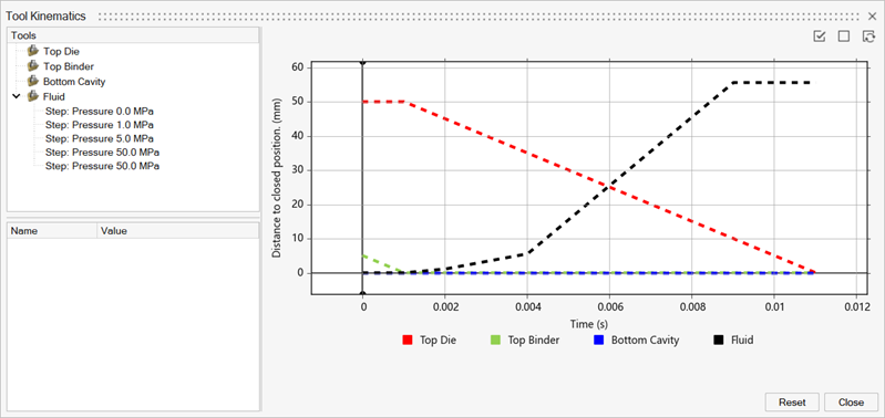

    Fluid
    Kinematics: Stationary (cannot be modified).
    Motion Control:
    • Select None if the pressure load is independent. Pressure starts at time zero or the previous step end time and ends based on the end time of the pressure curve (Default).
    • Select End @ if the pressure ends relative to the motion of another tool.
    Relative Tool: If End @ is selected, select the tool to use as the basis for pressure load.
    Position: Define the position for the selected relative tool.
    • Select End for the end of relative tool motion.
    • Select Distance to specify the relative tool's distance from the closed position. This option is available only when Motion Control is set to End@.
    Stroke: If Position is set to Distance, enter the selected relative tool's distance from the starting position.
