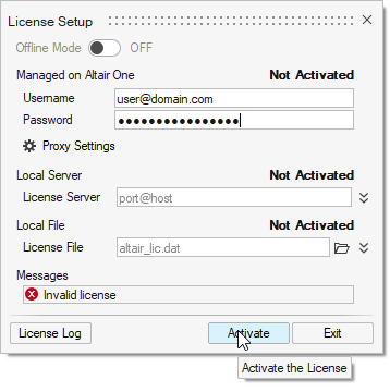

Access Managed Altair Licensing from the License Setup Dialog

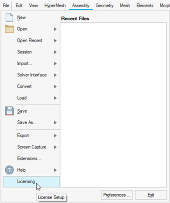

Open the License Setup dialog using one of the following options:
- If you have configured your license, navigate to .
- If you have not configured your license, the License Setup dialog shown in the next step displays automatically when you start the application.
In the License Setup dialog, enter your Altair One
credentials (Username and
Password) under the Managed on Altair One section.
Figure 2. License Setup Dialog
- Click Activate.

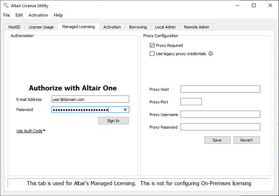

Access Managed Altair Licensing from the Altair License Utility
Start the Altair License Utility.
- On Windows, this is located in the start menu under Altair
2025.
You can also start it directly from:
<ALTAIR_INSTALL_PATH>\security\bin\win64\gui\almutil_gui.exe (usually C:\Program Files\Altair\2025\security\bin\win64\gui\almutil_gui.exe).
- On Linux, you can start it directly
from:
<ALTAIR_INSTALL_PATH>/altair/security/bin/linux64/gui (by default /root/2025/altair/security/bin/linux64/gui).
2025.
- Click the Managed Licensing tab.
- In the Authorization section, enter your Altair One credentials (E-mail Address and Password).
Click Sign In.

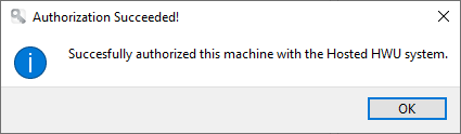

A message displays that the authorization was successful.Figure 4.
- Click OK.
