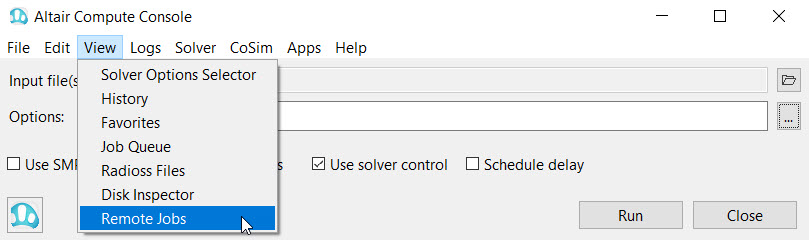

Remote jobs status can be checked from the GUI or Command Line.
Job submitted from the Command Line can be checked for status from GUI or vice-versa.

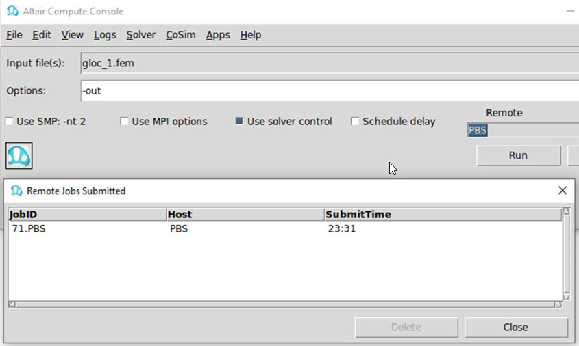

From the GUI, click .
Note: Check status of remote jobs is only for remote machines configured with Maintain SSH connection set to no.
With Maintain SSH connection set to yes, the status will be shown from the Log window until the job is completed. This option does not apply for PBS submission.

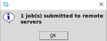

Figure 3.

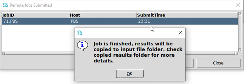

Figure 4.
