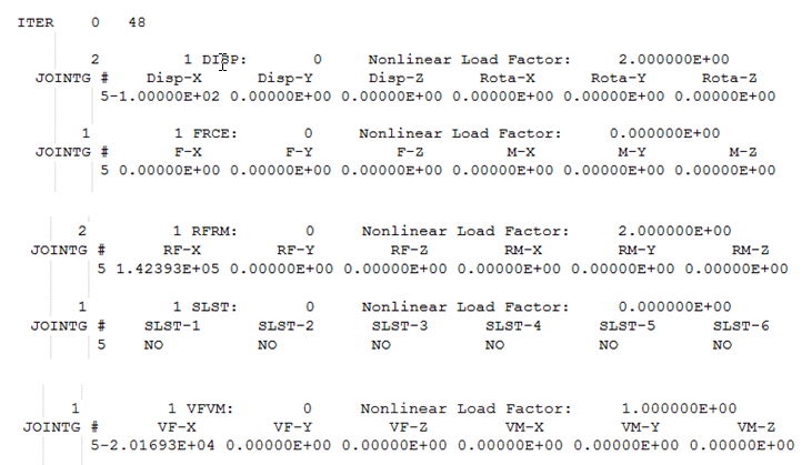

The .joint file has the following format.
| iter | Iteration | Numlds |
- iter
- Keyword denoting the beginning of a new iteration
- Iteration
- Iteration number
- NumIds
- Number of load increments for which this output is created
| Id | Number_of_els | DISP:Spc_id (or)
FRCE:Spc_id (or) RFRM:Spc_id (or) SLST:Spc_id (or) VFVM:Spc_id |
Nonlinear Load Factor: # |

| JOINTG # EID | Disp-X | Disp-Y | Disp-Z | Rota-X | Rota-Y | Rota-Z |

| JOINTG # EID | F-X | F-Y | F-Z | M-X | M-Y | M-Z |

| JOINTG # EID | RF-X | RF-Y | RF-Z | RM-X | RM-Y | RM-Z |

| JOINTG # EID | SLST-1 | SLST-2 | SLST-3 | SLST-4 | SLST-5 | SLST-6 |

| JOINTG # EID | VF-X | VF-Y | VF-Z | VM-X | VM-Y | VM-Z |
