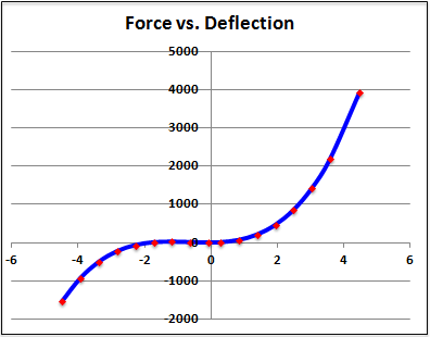

The example below shows a typical spline block in the .gbs file
for the FY direction. The plot below that shows the shape of the
curve.
$---------------------------------------------------------- SPLINE_STIFFNESS_FY
[SPLINE_STIFFNESS_FY]
(SPLINE_DATA)
{ disp force }
-4.48 -1538.03776
-3.93 -933.55971
-3.38 -506.77016
-2.83 -227.72161
-2.28 -66.46656
-1.73 6.94249
-1.18 22.45304
-0.63 10.01259
-0.09 -0.43487
0.28 8.16256
0.83 66.78761
1.38 206.90616
1.93 458.46571
2.48 851.41376
3.03 1415.69781
3.58 2181.26536
4.47 3922.99269
