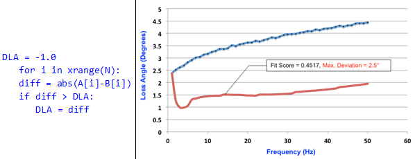

| Loss Angle | Let A(xk), k=0…N-1 be a set of data points measured
experimentally. Let B(xk), k=0…N-1 be the corresponding set of data points from the analytical model. Let the
deviation metric for Dynamic Stiffness be DLA.
The pseudocode for calculating DLA is: ![]() |
