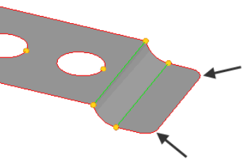

to remove all at once.Locations Select two locations on surface edges to remove cuts. Surfaces Select surfaces to remove fillets and rounds. Similar to surface fillets, edge fillets create smooth curves at the intersection of relatively perpendicular free edges.
An edge fillet is a part of the trimming loop of a surface that can be roughly equivalenced to a circular arc.Figure 2. Edge Fillets
