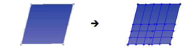

Extract Parametric Lines Create lines at parametric locations on surfaces. - From the guide bar, select Surfaces to select a surface that the parametric values are in reference to.
- From the microdialog, define the following:
- Along U
- Specify the number of lines created between the
lower and upper u bounds.
- If specified as 0, no lines are created along the u direction.
- If specified as 1, a line is created at the lower u bound only.
- If specified as 2, lines are created at both the upper and lower u bounds.
- If specified > 2, lines are created at linear intervals between the lower and upper u bounds.
- Along V
lower and upper v bounds.
- If specified as 0, no lines are created along the v direction.
- If specified as 1, a line is created at the lower v bound only.
- If specified as 2, lines are created at both the upper and lower v bounds.
- If specified > 2, lines are created at linear intervals between the lower and upper v bounds.
- Auto-imprint
- 1D elements drawn on FE geometry remesh the surface; on CAD geometry, they imprint an edge.
