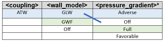

The acceptable combinations when using the various coupling methods are shown below. The shaded blue boxes indicate default combinations. The line indicates the allowed combination.
Adaptive Two-Way Coupling (default)
*With ATW, if GWF is applied, the default pressure gradient is full.
** With ATW, if GLW is applied, the option of pressure gradient off is acceptable.

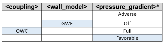

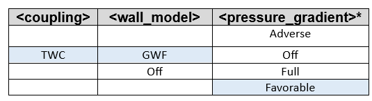

Two-way coupling
One-way coupling

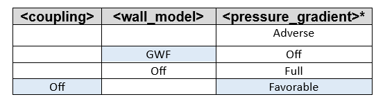

Coupling off
Figure 4.
