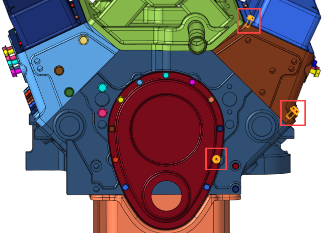

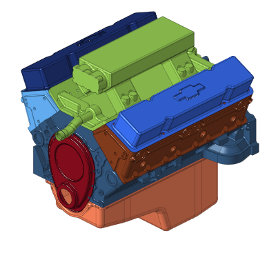

Select the three bolts parts highlighted in the figure below.
Right-click and select .
The tool searches for all bolts matching the features of the highlighted parts and isolates them on the screen.
- Left-click and drag to select all the bolts on the screen then right-click and select Create Group.
- Label the group Misc then click Create.
Right-click and select Reverse (R) to display all the
parts besides the bolts.
Figure 3.
- Left-click and drag to select all the parts on the screen then right-click and select Create Group.
- Label the group ToWrap then click Create.

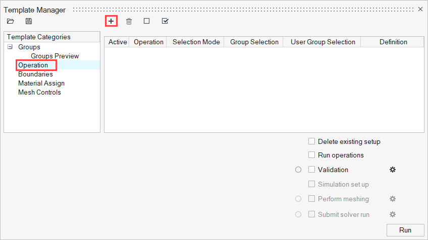

Create the Template
Click the arrow next to the Home tool set, then
select Template Manager.
Figure 4.
- Select Operation from the list of categories in the Template Manager dialog.
Click
to add an operation.

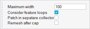

Figure 7.
Click
and enter a maximum width of
100.
Figure 8.

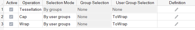

- Double-click in the Operation column and select Wrap.
- Under the Selection Mode column, select By user groups.
Under the User Group Selection column, select
ToWrap.

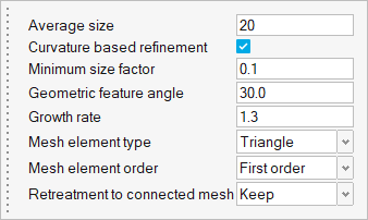

Figure 9.
Click
and enter a value of 20 for
the Average element size.

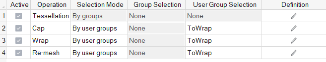

Click
to add another operation.
- Double-click in the Operation column and select Re-mesh.
ToWrap.
Figure 11.
Click
the Average size.
Figure 12.

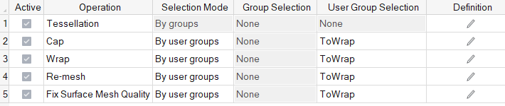

- Double-click in the Operation column and select Fix Surface Mesh Quality.
ToWrap.

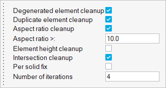

Figure 13.
Click
and enable Degenerated element
cleanup, Duplicate element cleanup,
Aspect ratio cleanup, and Intersection
cleanup.
Figure 14.

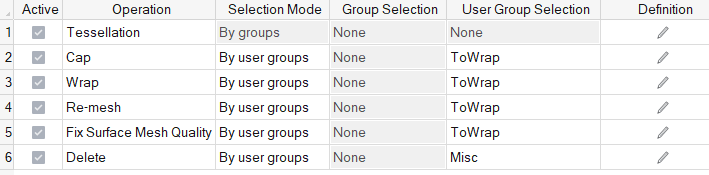

Click
- Double-click in the Operation column and select Delete.
Misc.
Figure 15.

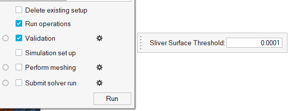

- At the bottom of the dialog, enable Run operations and Validation.
Click
next to Validation and set the Sliver Surface Threshold to
0.0001.
Figure 16.
- Click Run to execute the template.
